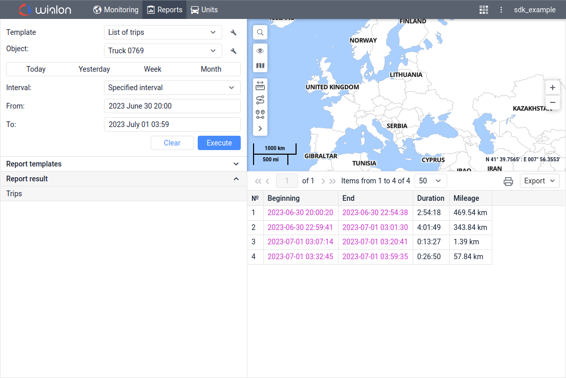

Let’s imagine, it we need to obtain the results of the the report List of trips, available to the user authorized by a token, for the unit Truck 0769 (system ID 55555) for the time interval from 2023 June 30 20:00 to 2023 July 01 03:59 (GMT+0) and export it to a PDF file using API requests.
In the web interface, the result looks as follows:

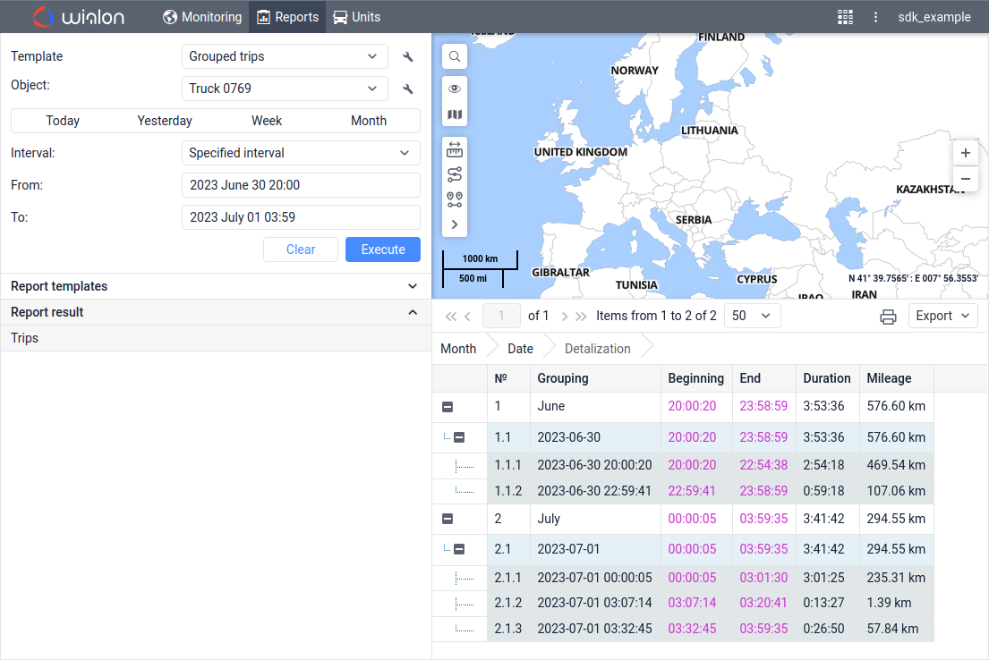

Working with a report with grouping
Now we need to obtain the results of the report Grouped trips, available to the user authorized by a token, for the unit Truck 0769 (system ID 55555) for the time interval from 2023 June 30 20:00 to 2023 July 01 03:59 (GMT+0) and export it to a PDF file using API requests.
Based on the result in the web interface, you can see that the Trips table has grouping by months and dates, meaning the report has 3 levels of nesting:
  • The first level contains rows with months.
    The second level contains rows with dates within the month.
  • The third level contains rows with trips within the date.

    "reportResult":{
        "msgsRendered":0,
        "stats":[],
        "tables":[
                "name":"unit_trips",
                "label":"Trips",
                "grouping":{
                    "nested":{
                        "type":"day"
                    "type":"month"
                "flags":4491,
                "rows":2,
                "level":3,
                "columns":6,
                "header":[
                    "Grouping",
                    "Beginning",
                    "End",
                    "Duration",
                    "Mileage"
                "header_type":[
                    "time_begin",
                    "time_end",
                    "duration",
                    "mileage"
        "attachments":[]
Three key parameters from the response that are important for us here are as follows:
  • tables — shows the number of tables in the report as an array. In this case, only one table (Trips) is mentioned, therefore its index will be 0.
  • rows — the number of rows in the table, which is 2 in this case. Therefore, their indexes range from 0 to 1. This refers only to the rows at the top level of nesting, there may be more inside.
  • level — the number of levels of nesting, which is 3 in this case, as there is grouping in the report. Therefore, there are levels with indexes from 0 to 2 in the table.

6. Selecting rows in a multi-level table
Knowing the index of the table content, let’s display it using the request report/select_result_rows.
https://hst-api.mos-glonass.com/wialon/ajax.html?svc=report/select_result_rows&params={"tableIndex":0,"config":{"type":"range","data":{"from":0,"to":1,"level":2}}}&sid=SESSION_IDENTIFIER
Parameter and its value Description
“tableIndex”:0 The content of the table with index 0 will be displayed.
“type”:“range” A sequence of rows will be requested.
“from”:0 The first displayed row will have index 0.
“to”:1 The last displayed row will have index 1.
“level”:2 The result will display nesting levels up to index 2.
Response
        "n":0,
        "i1":0,
        "i2":1188,
        "t1":1688144420,
        "t2":1688158739,
        "d":1,
        "c":[
            "1",
            "June",
                "t":"20:00:20",
                "v":1688144420,
                "y":47.2941741943,
                "x":26.4906959534,
                "u":55555
                "t":"23:58:59",
                "v":1688158739,
                "y":43.1049079895,
                "x":25.6173667908,
                "u":55555
            "3:53:36",
            "576.60 km"
        "r":[
                "n":0,
                "i1":0,
                "i2":1188,
                "t1":1688144420,
                "t2":1688158739,
                "d":2,
                "c":[
                    "1.1",
                    "2023-06-30",
                        "t":"20:00:20",
                        "v":1688144420,
                        "y":47.2941741943,
                        "x":26.4906959534,
                        "u":55555
                        "t":"23:58:59",
                        "v":1688158739,
                        "y":43.1049079895,
                        "x":25.6173667908,
                        "u":55555
                    "3:53:36",
                    "576.60 km"
                "r":[
                        "n":0,
                        "i1":0,
                        "i2":790,
                        "t1":1688144420,
                        "t2":1688154878,
                        "d":0,
                        "c":[
                            "1.1.1",
                            "2023-06-30 20:00:20",
                                "t":"20:00:20",
                                "v":1688144420,
                                "y":47.2941741943,
                                "x":26.4906959534,
                                "u":55555
                                "t":"22:54:38",
                                "v":1688154878,
                                "y":43.8697662354,
                                "x":26.0177116394,
                                "u":55555
                            "2:54:18",
                            "469.54 km"
                        "n":1,
                        "i1":936,
                        "i2":1188,
                        "t1":1688155181,
                        "t2":1688158739,
                        "d":0,
                        "c":[
                            "1.1.2",
                            "2023-06-30 22:59:41",
                                "t":"22:59:41",
                                "v":1688155181,
                                "y":43.8698196411,
                                "x":26.0177154541,
                                "u":55555
                                "t":"23:58:59",
                                "v":1688158739,
                                "y":43.1049079895,
                                "x":25.6173667908,
                                "u":55555
                            "0:59:18",
                            "107.06 km"
        "n":1,
        "i1":1193,
        "i2":2910,
        "t1":1688158805,
        "t2":1688173175,
        "d":1,
        "c":[
            "2",
            "July",
                    "t":"00:00:05",
                    "v":1688158805,
                    "y":43.0983314514,
                    "x":25.6316585541,
                    "u":55555
                    "t":"03:59:35",
                    "v":1688173175,
                    "y":41.5760040283,
                    "x":26.9871864319,
                    "u":55555
                "3:41:42",
                "294.55 km"
        "r":[
                "n":0,
                "i1":1193,
                "i2":2910,
                "t1":1688158805,
                "t2":1688173175,
                "d":3,
                "c":[
                    "2.1",
                    "2023-07-01",
                        "t":"00:00:05",
                        "v":1688158805,
                        "y":43.0983314514,
                        "x":25.6316585541,
                        "u":55555
                        "t":"03:59:35",
                        "v":1688173175,
                        "y":41.5760040283,
                        "x":26.9871864319,
                        "u":55555
                    "3:41:42",
                    "294.55 km"
                "r":[
                        "n":0,
                        "i1":1193,
                        "i2":2171,
                        "t1":1688158805,
                        "t2":1688169690,
                        "d":0,
                        "c":[
                            "2.1.1",
                            "2023-07-01 00:00:05",
                                "t":"00:00:05",
                                "v":1688158805,
                                "y":43.0983314514,
                                "x":25.6316585541,
                                "u":55555
                                "t":"03:01:30",
                                "v":1688169690,
                                "y":41.7139854431,
                                "x":26.3660545349,
                                "u":55555
                            "3:01:25",
                            "235.31 km"
                        "n":1,
                        "i1":2340,
                        "i2":2486,
                        "t1":1688170034,
                        "t2":1688170841,
                        "d":0,
                        "c":[
                            "2.1.2",
                            "2023-07-01 03:07:14",
                                "t":"03:07:14",
                                "v":1688170034,
                                "y":41.7140579224,
                                "x":26.365901947,
                                "u":55555
                                "t":"03:20:41",
                                "v":1688170841,
                                "y":41.7122383118,
                                "x":26.3712425232,
                                "u":55555
                            "0:13:27",
                            "1.39 km"
                        "n":2,
                        "i1":2833,
                        "i2":2910,
                        "t1":1688171565,
                        "t2":1688173175,
                        "d":0,
                        "c":[
                            "2.1.3",
                            "2023-07-01 03:32:45",
                                "t":"03:32:45",
                                "v":1688171565,
                                "y":41.7120819092,
                                "x":26.3711204529,
                                "u":55555
                                "t":"03:59:35",
                                "v":1688173175,
                                "y":41.5760040283,
                                "x":26.9871864319,
                                "u":55555
                            "0:26:50",
                            "57.84 km"
