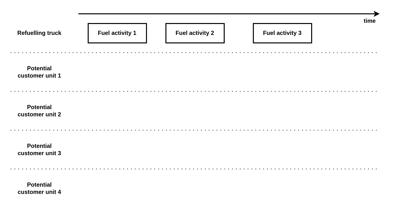

Let’s take a step-by-step look at the operation logic of the Fuel Traffic table for the case when it is executed for a refuelling truck.
When running a report for the selected interval, the table searches the refuelling truck for Fillingies of various types: fuel fillings, drains, or counter performance. The search is carried out in the same way as in the tables of the same name — Fuel Fillings and Battery Charges, Fuel Drains, and Counter Sensors. It is possible to filter the types of fuel actives to be displayed in the table settings. The logic of working with all three types of activities is the same. For simplicity, let’s assume that only fuel dispensing is considered in the example.

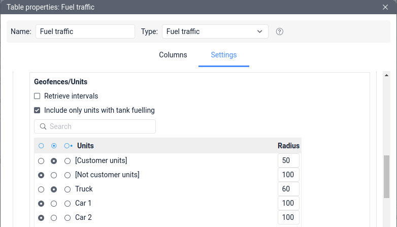

Next, the system looks for potential customers, that is, other units that were close to the refuelling truck during its fuel activities. The distance to these units is compared with the radius of approximation, which is specified in the settings of the Fuel Traffic table. Let’s assume that several such units are found.
The next step, the system starts searching for fuel fillings for the units found nearby. The search is carried out in the same way as in the Fuel Fillings and Battery Charges table.
Fuel fillings for potential customers are calculated for the entire report interval, and not only for the time when they were near the refuelling truck at the time of fuel dispensing. This is explained as follows:
  • FLS can be inertial, i.e. display the change of the level not immediately, but with some delay.
  • Wialon uses smoothing by neighboring messages in order to compensate for inaccuracies in the FLS. Thus, for the correct calculation of the filling, it is necessary to take into account the messages before it starts and after it ends.
If the Include only units with tank fuelling option is enabled in the table settings, then units without fillings will be excluded from further analysis and display. And if this option is disabled, then the report will include even those units that were simply near the refuelling truck at the time of fuel activities, but did not have fillings. Let’s suppose that the option Include only units with tank fuelling is enabled in our example.

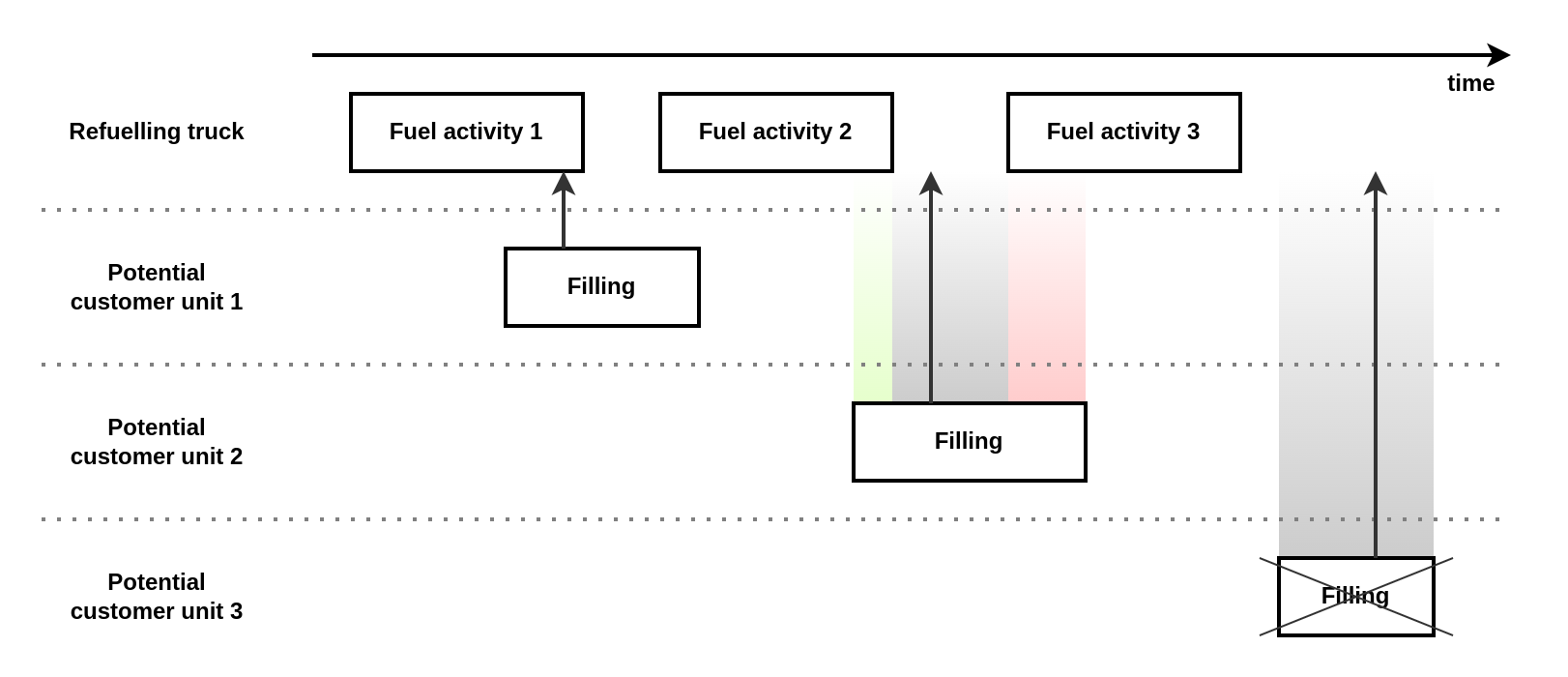

If the filling time of a potential customer falls within the fuel activity, then the filling and fuel activity are considered to be adjacent. If such a hit did not happen, then the algorithm looks for intersections of the filling interval with the interval of fuel activity. If there are several such intersections, then the filling will be adjacent to the first fuel activity in terms of time. If the filling interval does not intersects with any fuel activity, then the customer unit and its filling will not be displayed in the report.

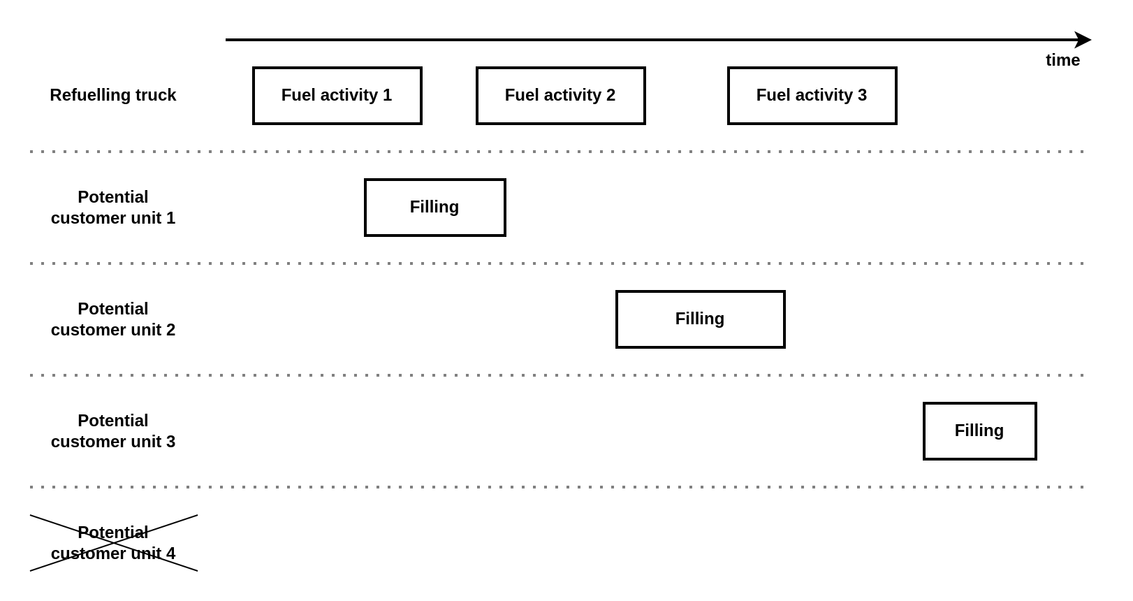

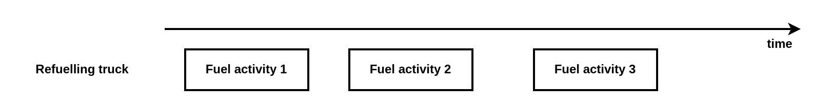

In the example shown in the pictures, we get:
  • The fuel activity 1 row will display the fuel filling of the potential customer 1. In this case, the filling time (maximum fuel level difference) of the customer unit falls within the dispensing interval.
  • The fuel activity 2 row will display the fuel filling of the potential customer 2. The time of this filling does not fall within the dispensing intervals, however, the fuel filling has intersections with several dispensing activities and will be related to the very first one.
  • No fuel fillings will be displayed in the fuel activity 3 row. The filling interval of the potential customer 3 does not overlap with any fuel dispensing.
  • The potential customer 4 will not be displayed in the report. No fuel fillings were detected for it, and according to the condition of the example, the option Include only units with tank fuelling is enabled in the table settings.

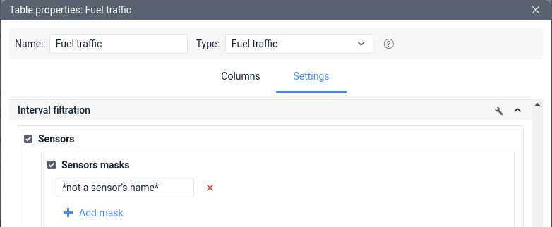

  • If the fuel dispenser does not have a fuel filling gun with flow meter installed, while other counter sensors are created for the unit, they may affect the displayed result. To hide the readings of these counters, open the Sensors block in the interval filtration, enable the Sensor masks filter in it, and specify a name that does not match the names of the counters.

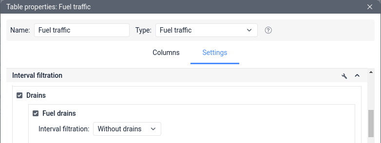

  • If a refuelling truck is equipped with a fuel filling gun with flow meter, it is recommended to work with its data and not with fuel drains detected by the FLS. To hide fuel drains from the fuel dispenser, open the Drains block in the interval filtration, enable the Fuel drains filter in it, and select the Without drains option in the drop-down menu.

If several units were found nearby, the report displays the name of the unit with the smallest radius of approximation. If the radii match, then all units are displayed in the report.

You can check location-related tracker configurations or increase the radius of approximation in the settings of the Fuel Traffic table.
