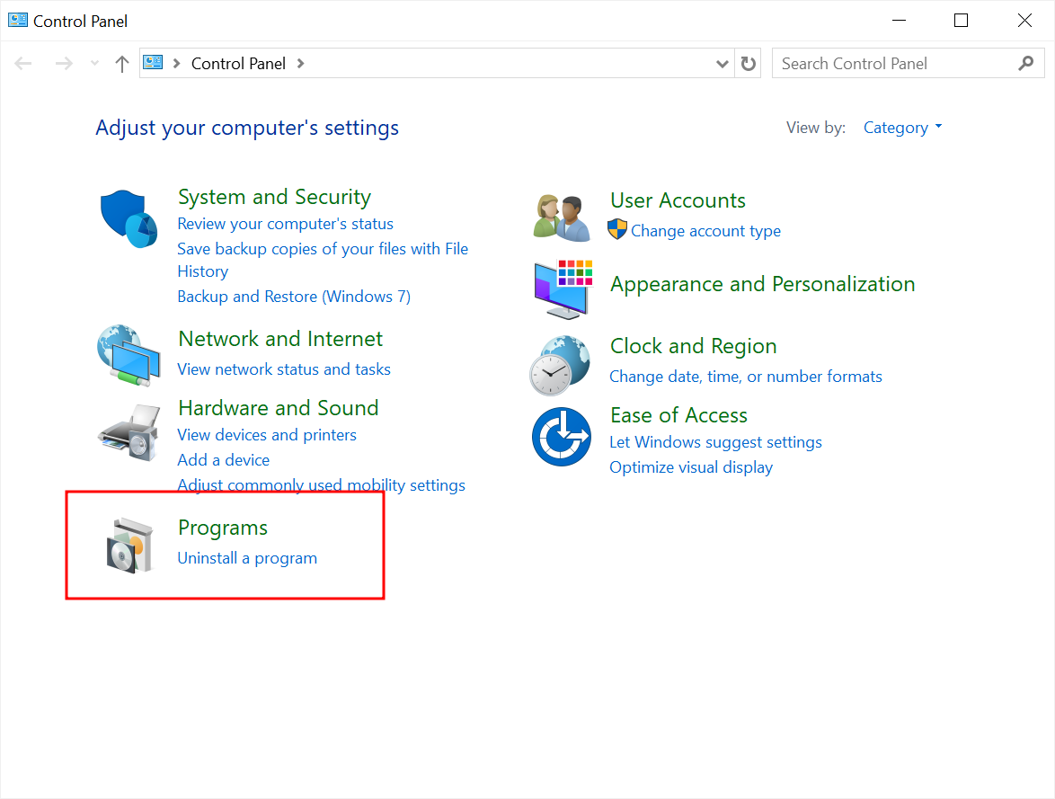

  1. Press Win on the keyboard and type ‘Control Panel’. Then click it in the search results.
  2. Select Programs.

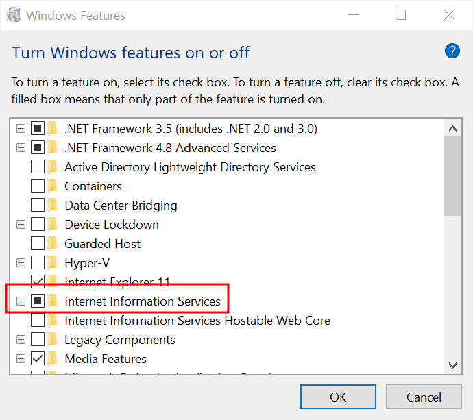

  3. At Programs and Features, click Turn Windows features on or off.
  4. In the new window, click the checkbox next to Internet Information Services and press OK.

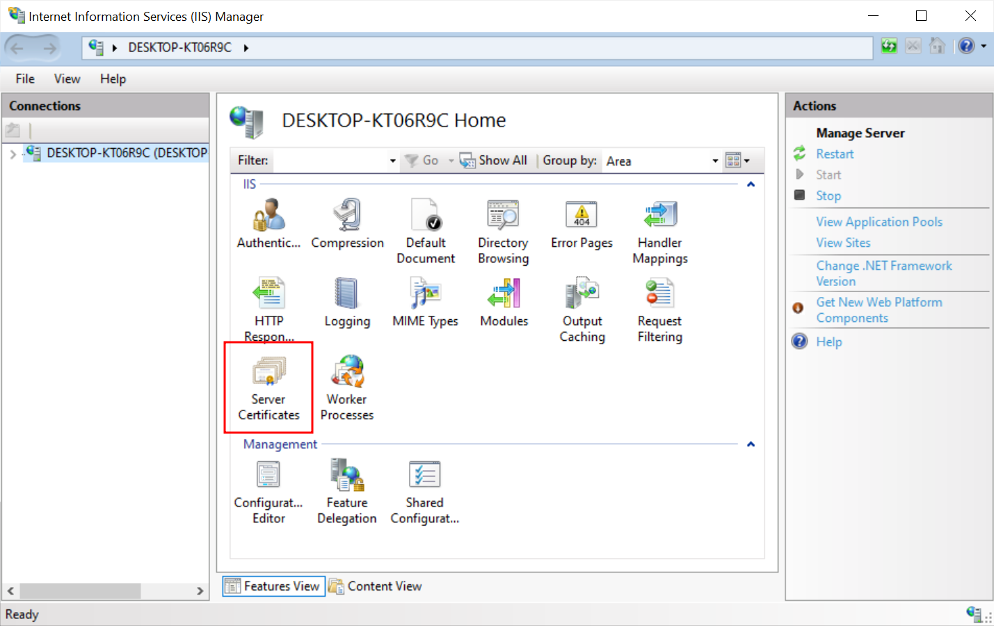

  8. Double-click the Server Certificates icon in the center panel of the window.

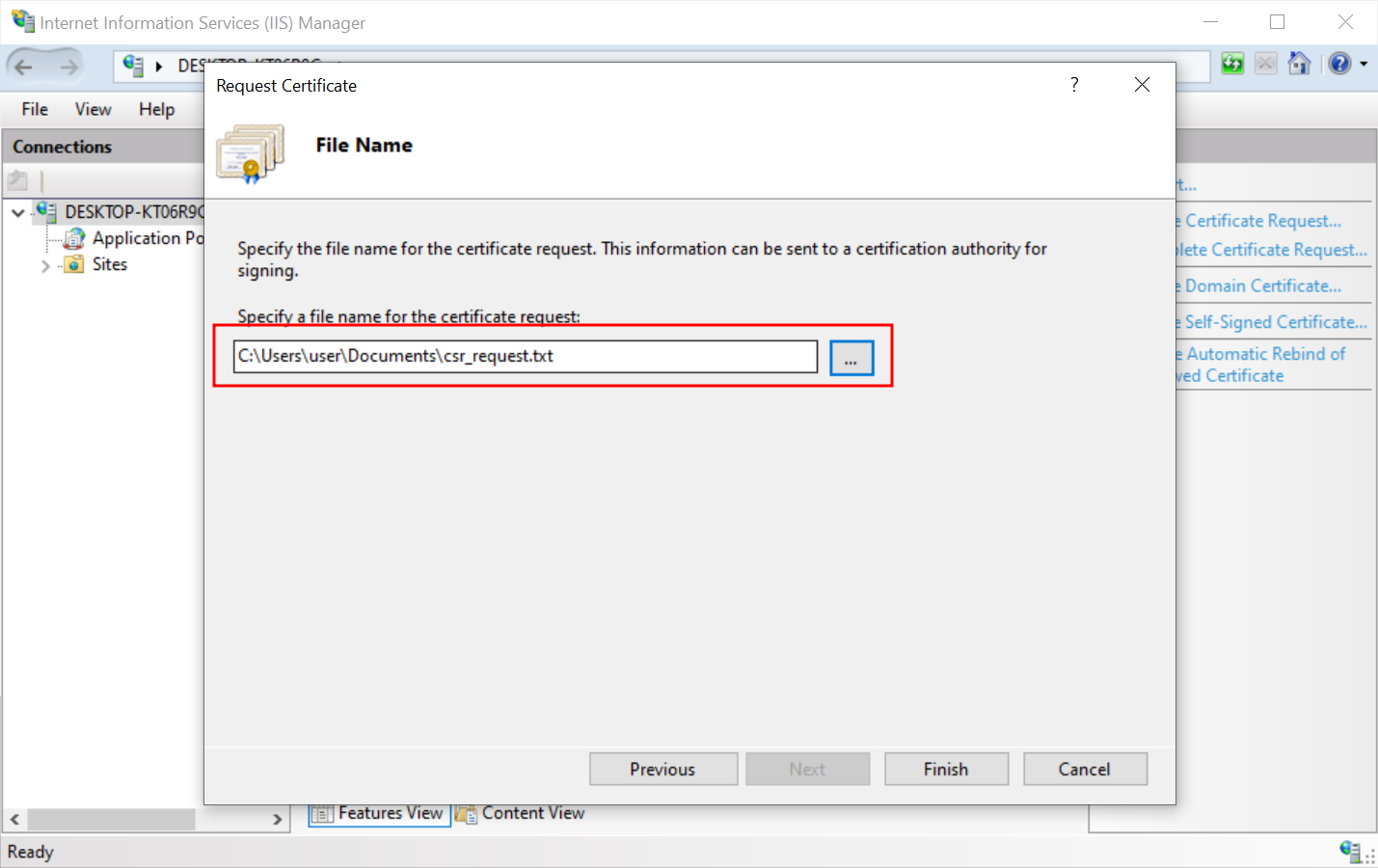

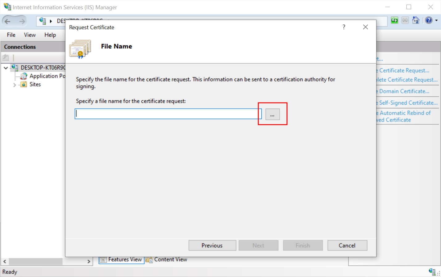

  12. Click the button with three dots to select where the CSR request should be placed and add its name. Press Finish.

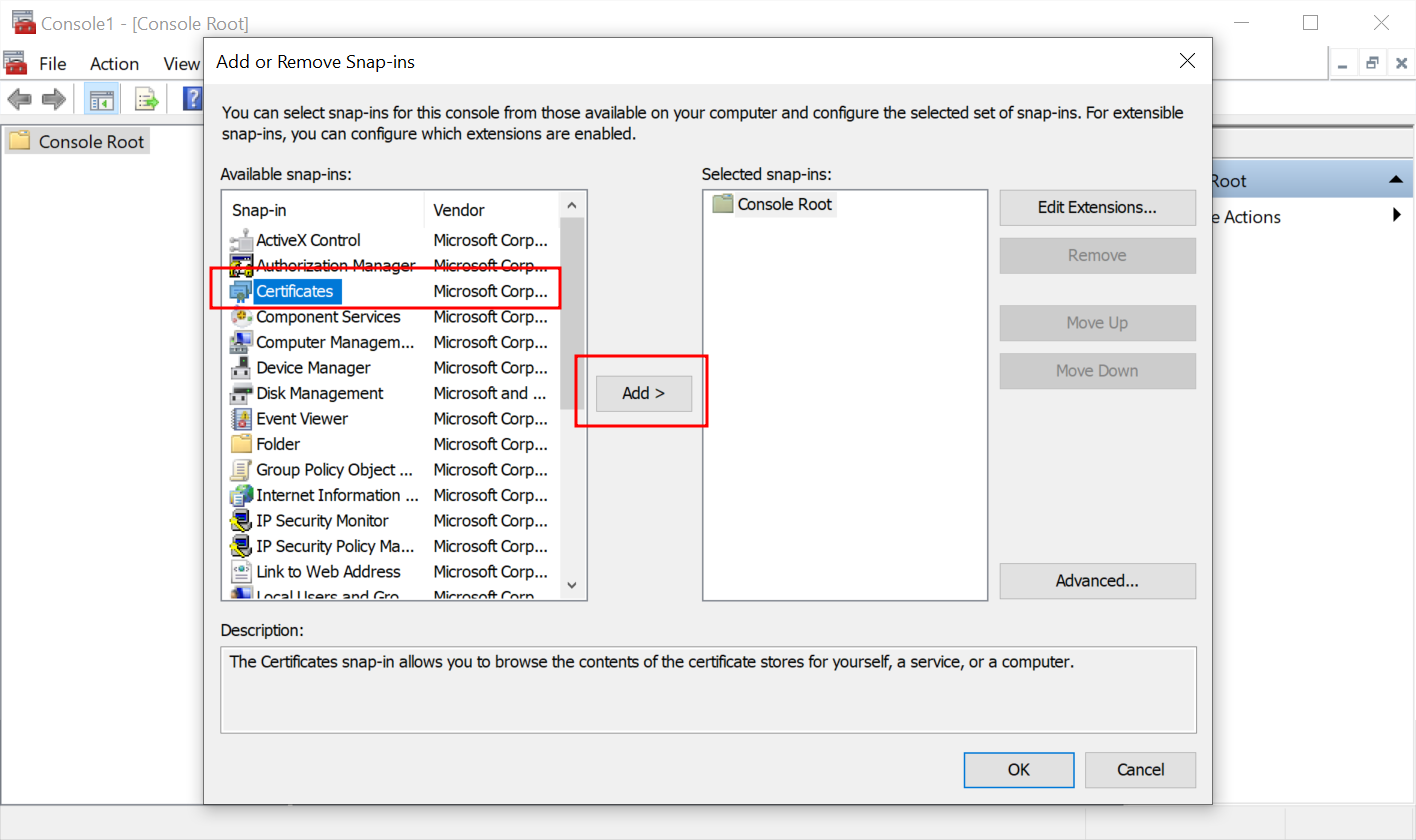

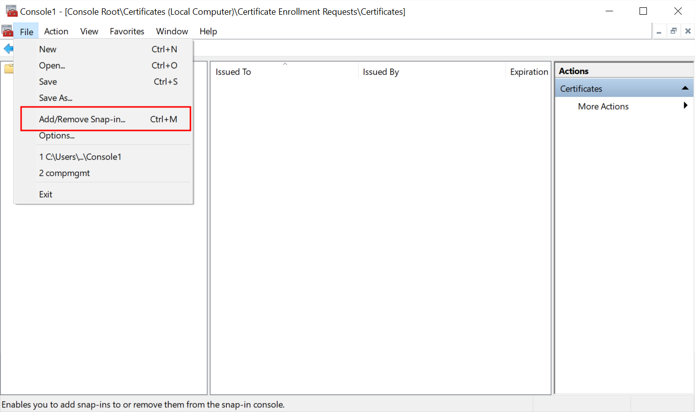

  15. In the new window, press File > Add/Remove Snap-in…
  16. In the new window, in the left column, select Certificates and press Add > button.

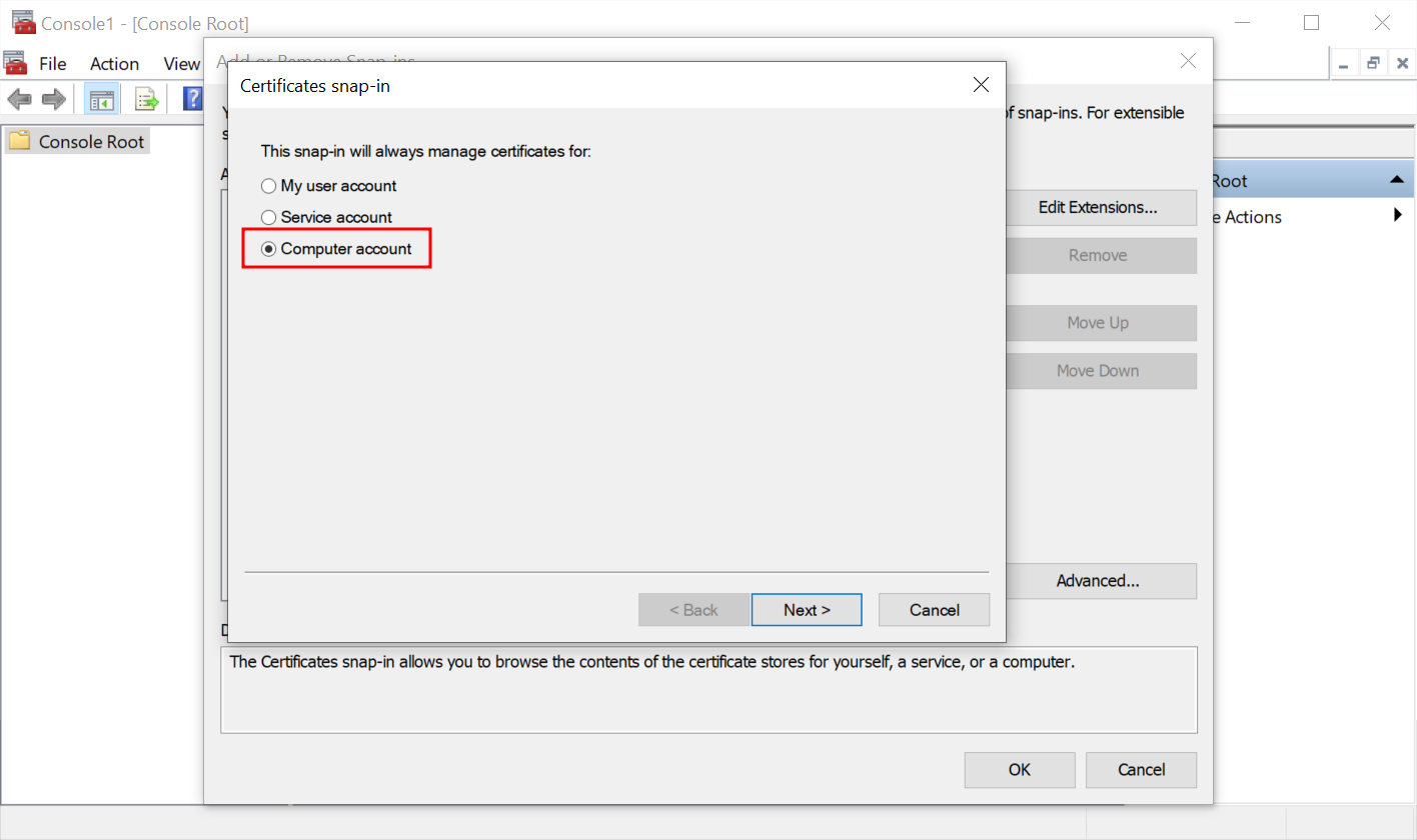

  17. This snap-in will always manage certificates for Computer account and press Next.

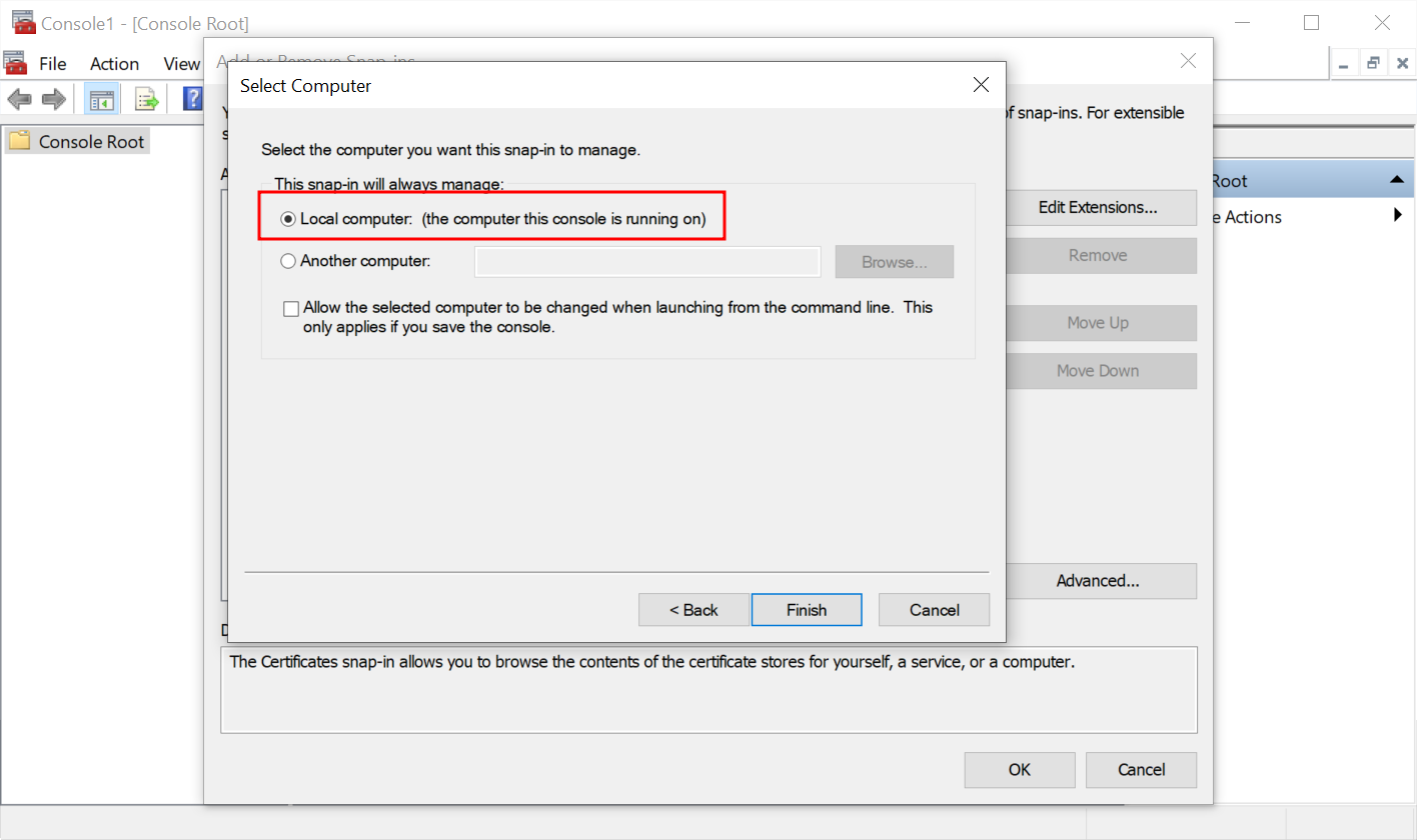

  18. This snap-in will always manage Local computer (the computer this console is running on) and press Finish.

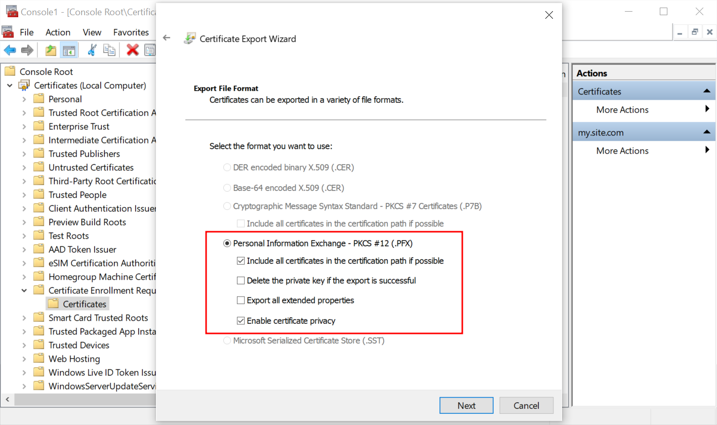

  23. Select the format Personal Information Exchange - PKCS #12 (.PFX).

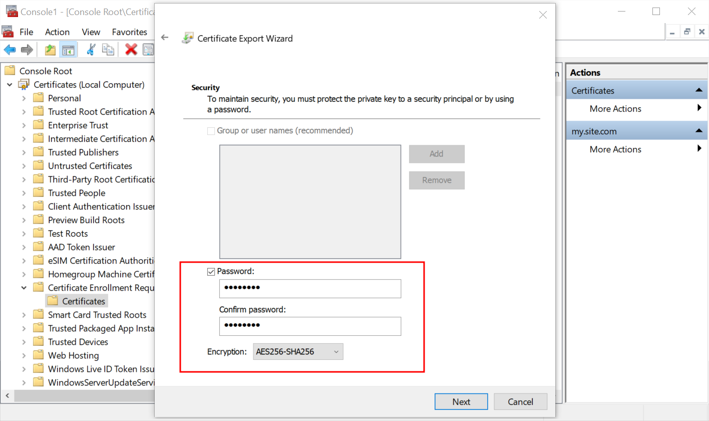

  24. On the next step, mark the Password option. Enter the desired password in the Password and Confirm password fields and press Next.

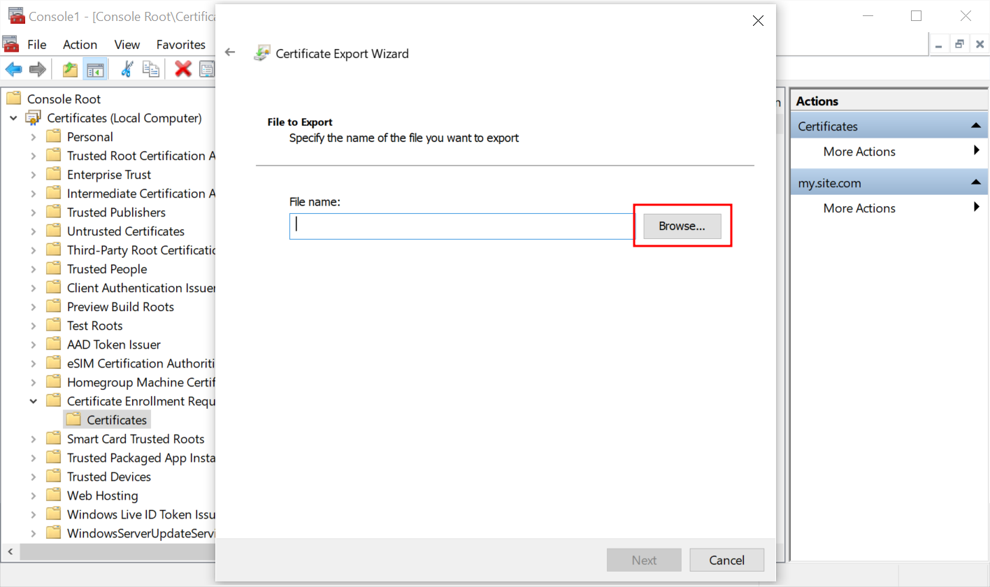

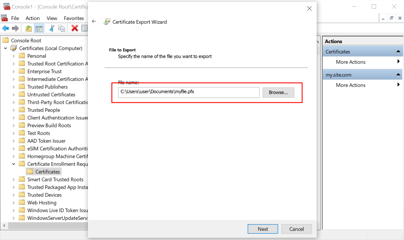

  25. Click the Browse… button to select where the files should be saved and set the filename. Press Next.

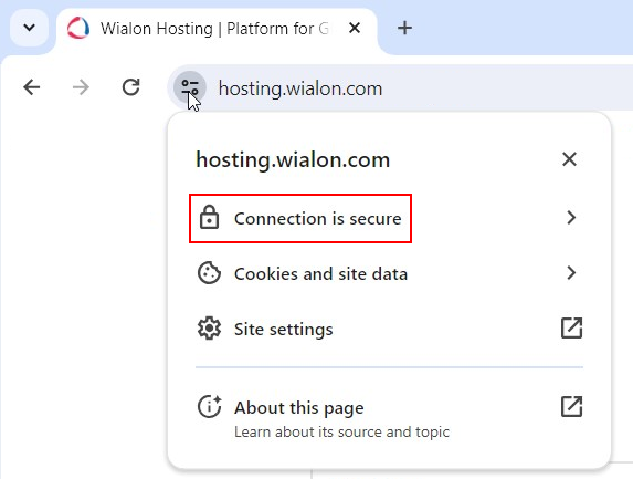

How can I know when the certificate expires?

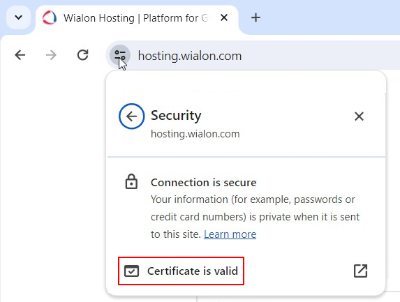

The easiest way is to visit your site by following the instructions:
  1. Open your site in the browser.
  2. Click on the icon near the address bar of the browser.
  3. In the pop-up window, click on the Connection is secure.

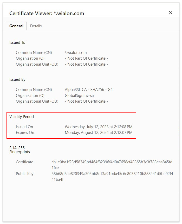

  4. Then click on the Certificate is valid.
  5. Check the field Expires On in the new window.
