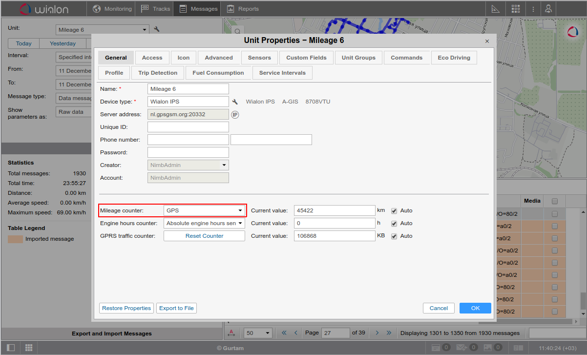

If you’re faced with the problem of incorrect mileage detection in a report, on a track, or in messages, the first thing you should do is to check what type of mileage counter is selected on the General tab in the unit properties:
  • GPS
  • GPS + ignition sensor
  • Mileage sensor
  • Relative odometer
After finding out which counter is used in your unit, choose the appropriate section of the article.

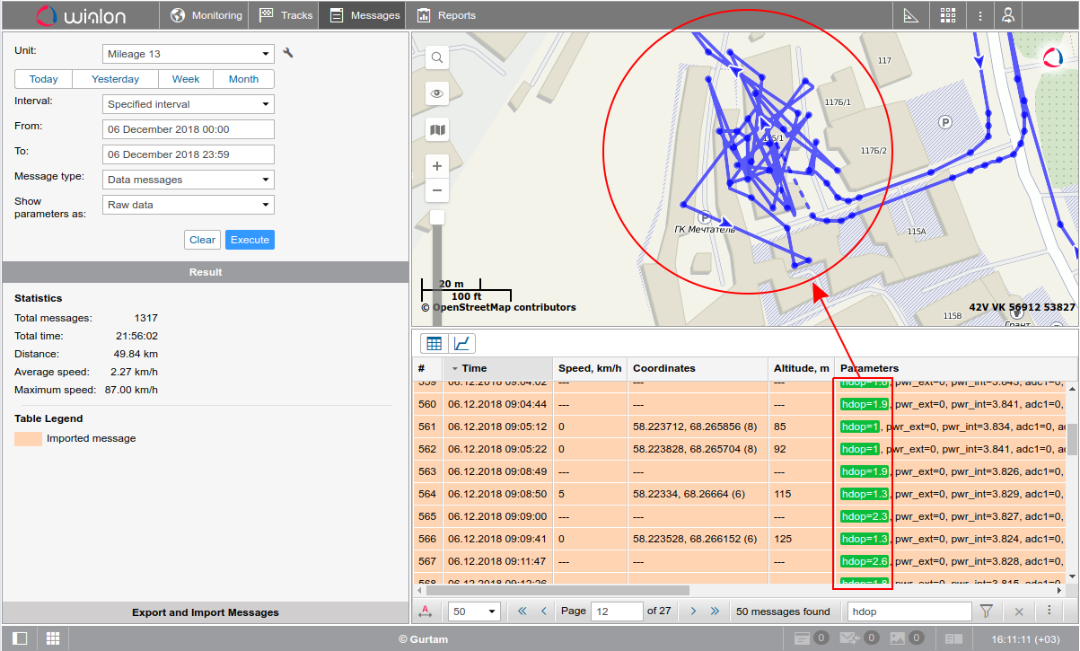

Outliers of coordinates may appear due to poor communication with satellites of the Global Navigation Satellite System (GNSS). To determine that outliers occurred, go to the Messages tab and upload data for the required unit for the problematic time interval. On the map, you will see a track that can be used to determine the fact of outliers: coordinates of messages are significantly spaced from the actual unit location.
In this example, a clear indication of problems with determining the unit location is the HDOP parameter — it has values >1.
Wialon has a limitation: no more than 1 message should come from a unit per 1 second. If the terminal transmits more than 1 message per 1 second, the chronology of messages may be disrupted and the track will look the same. The reason is incorrect arrangement of messages with positional data (coordinates) in the Wialon database. In such cases, you should reduce the frequency of sending messages with data in the terminal settings.
Possible solutions:

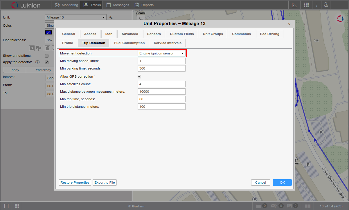

In the example above, we managed to get rid of outliers by using the ignition sensor in the trip detector, since they are detected in the interval when the ignition is switched off:

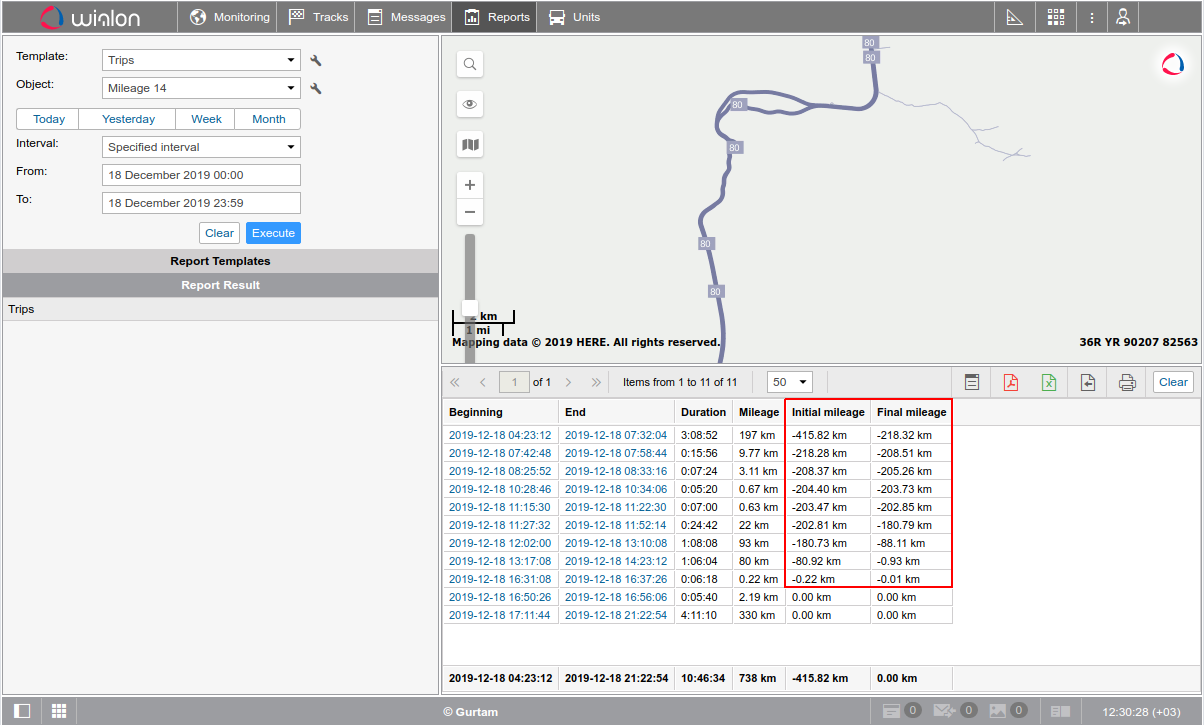

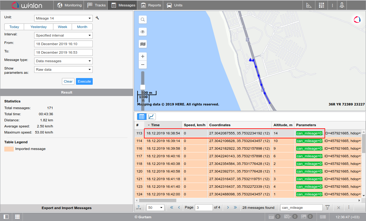

In such a situation, if due to some failures the mileage sensor didn’t work and sent 0 km, negative mileage values may appear:
In this example, a mileage sensor was created for the unit based on the can_mileage parameter, which is absent in messages until 12/18/2019 4:38:54 PM:
After 4:38 PM onwards, the parameter always has the value 0, and the sensor, respectively, has the value 0 km.
Possible solutions:
  • Remove the mileage sensor and completely switch to the mileage using GPS coordinates;
  • Fix the problem on the hardware side or switch to a parameter with correct values.
In the example above, the solution was to remove the sensor and switch to GPS mileage only, since the parameter values were not read from the CAN bus.

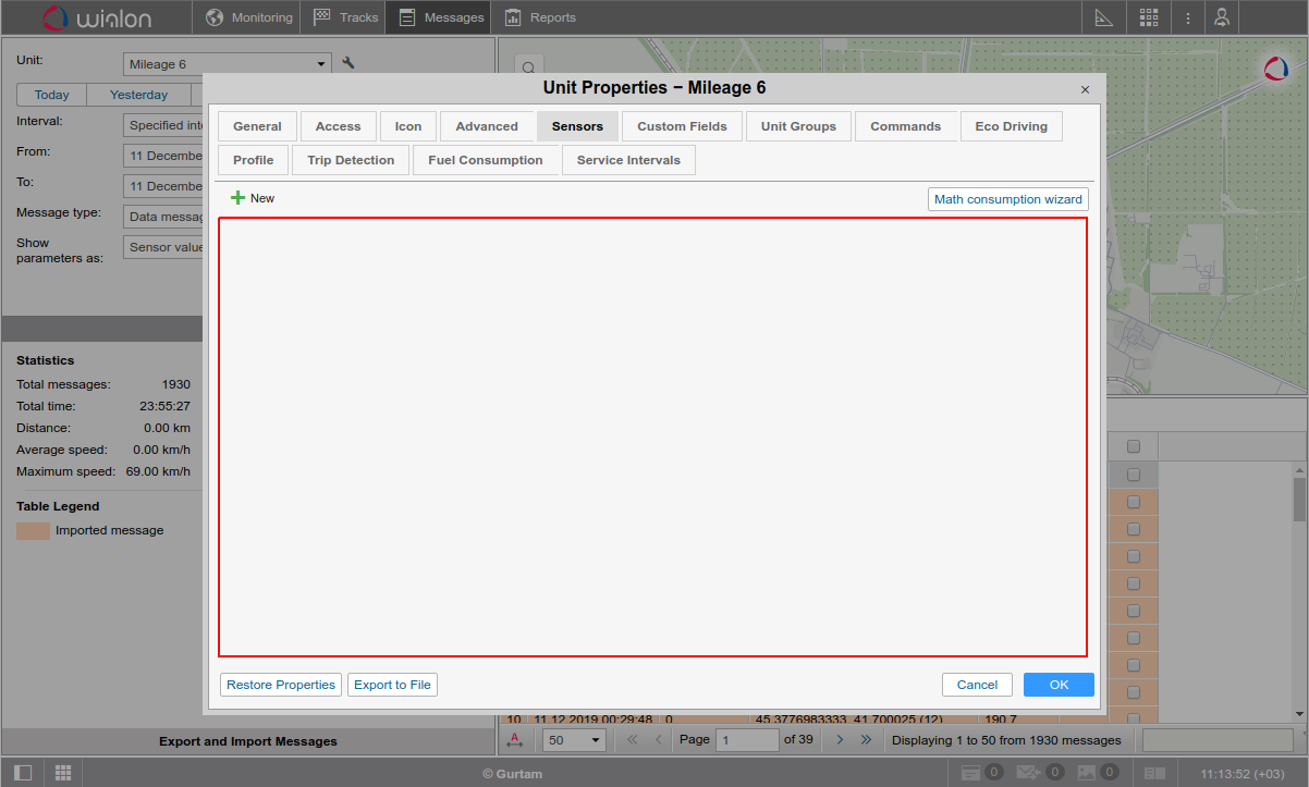

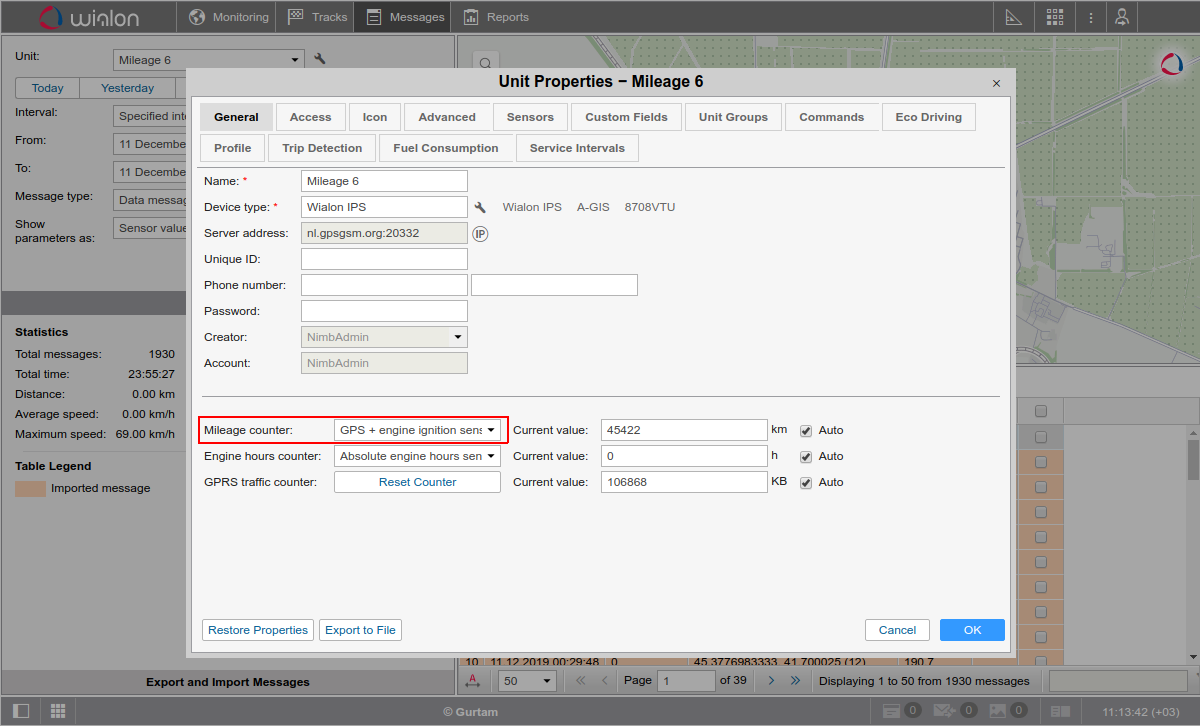

The GPS + ignition sensor option is selected as the mileage counter. When building a track (via the Messages, Tracks or Reports tab), the mileage is 0 km, while the track itself is displayed on the map:
The track on the map is built according to coordinates from messages, while the mileage calculation algorithm takes into account not only coordinates and distance between messages, but also checks if the ignition is on.
In this example, a sensor with the Ignition type is not created for the unit, so the system ignores all messages and displays 0 km of mileage:
Possible solutions:
  • Switch the mileage counter to GPS;
  • Add a correctly working ignition sensor.
In the example above, the unit doesn’t send a parameter based on which the ignition state can be determined, therefore the problem is solved by switching to the GPS counter type.

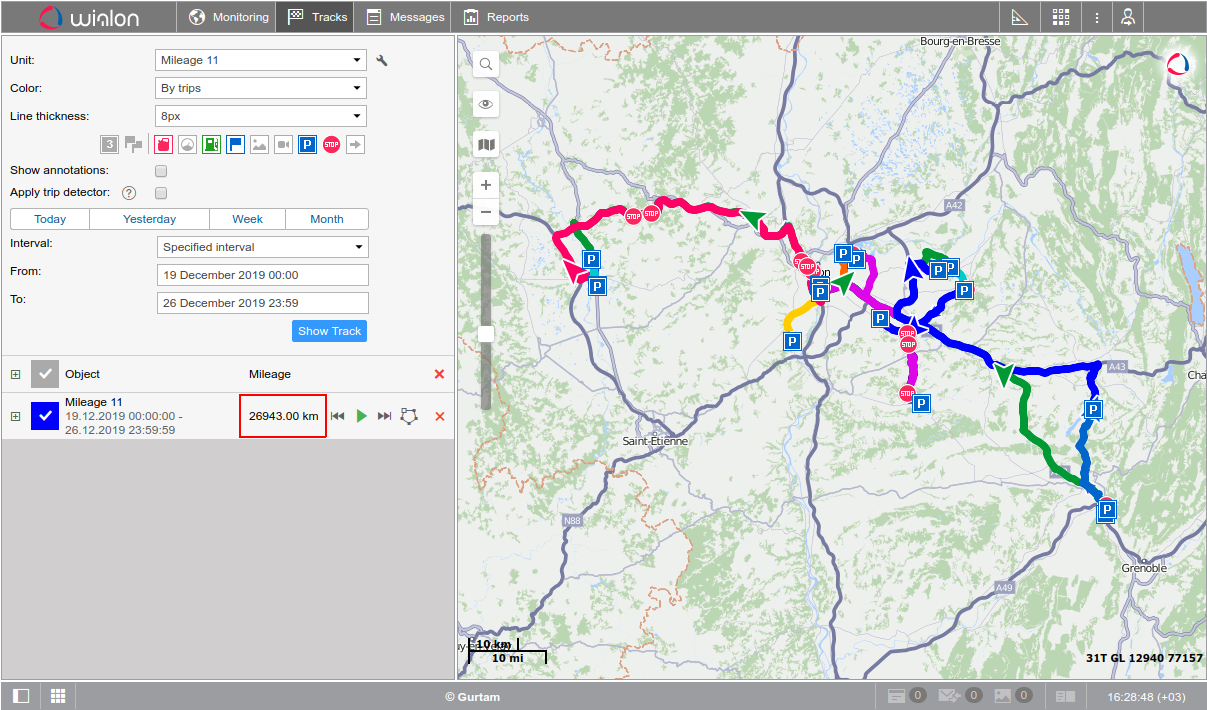

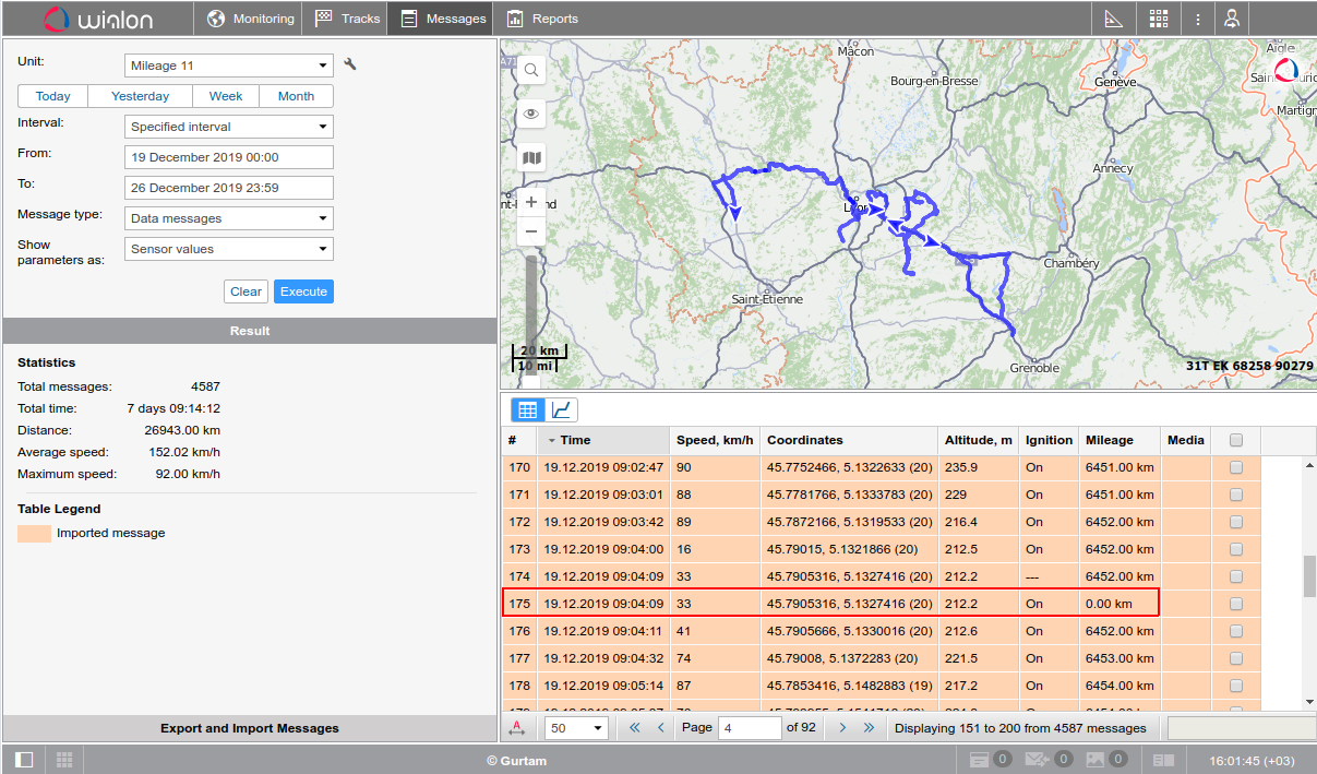

a. Resetting values of the mileage parameter

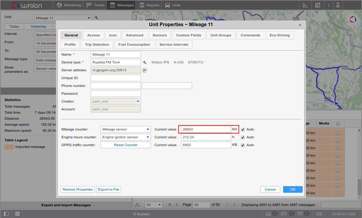

Some terminals stop transmitting mileage sensor readings for a short period of time (for example, due to power shutdown, pickups in the power supply circuit, other hardware issues). In such cases, the accumulated total mileage of the unit may differ from the last available sensor value:
In the example, the total mileage on the mileage counter is 26943 km, and on the mileage sensor — only 7069 km.
The reason is the reset of the mileage sensor parameter.
In such a situation, there occurs a reset to 0 km and then again an increase to 6452 km (in the example, such resets were repeated several times).
Possible solutions:

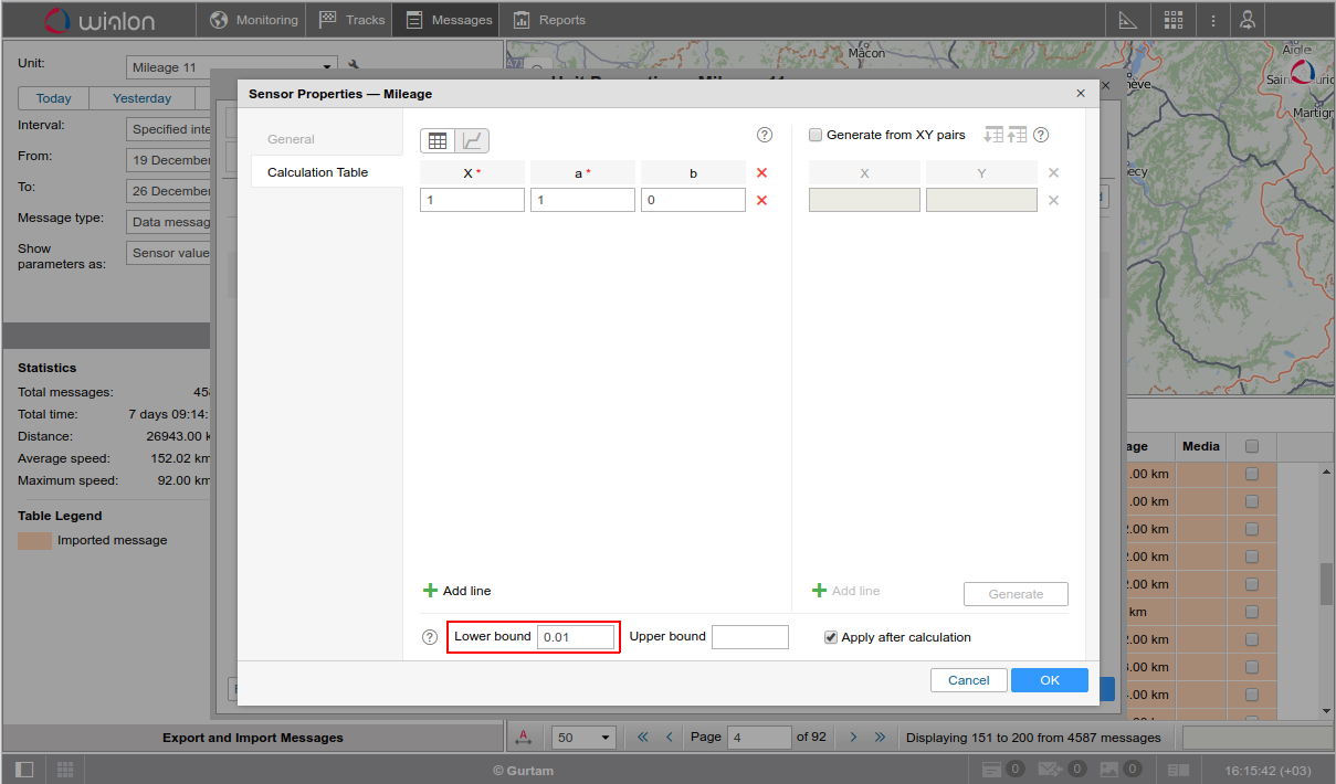

  • Use the Lower bound in the sensor settings;
  • Use Validation if the reset occurs under certain circumstances, and you can identify the dependence with other parameters (sensors).
In the example above, it is enough to apply the lower bound (0.01), since the reset occurs randomly and there is no dependence on other sensors.
Thus, by applying the lower bound, we managed to eliminate zero values (reset to 0 km) and avoid the incorrect mileage calculation.

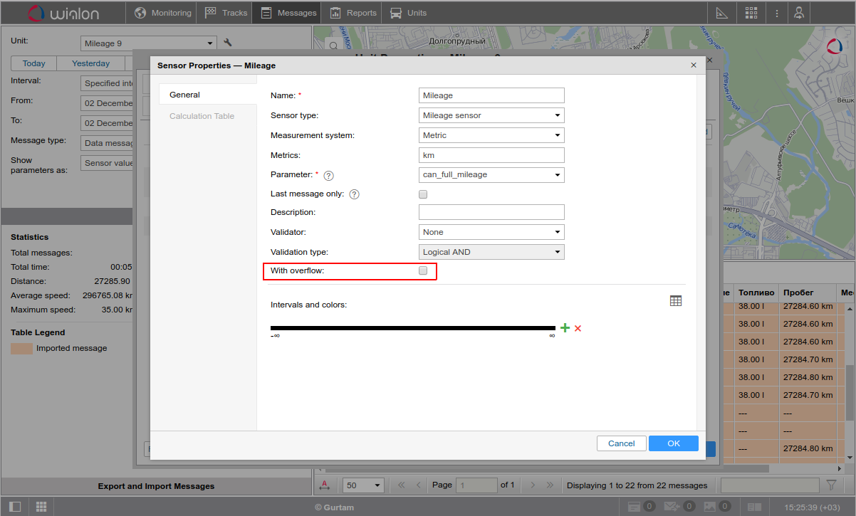

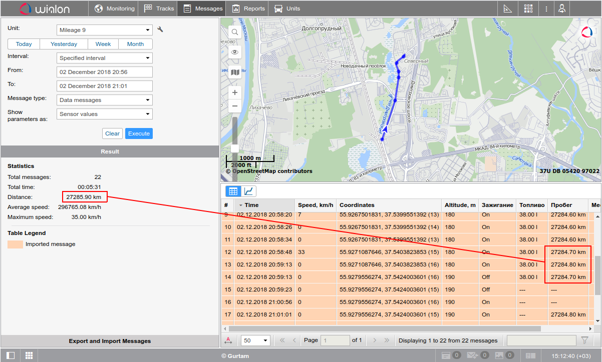

b. Messages with the same timestamp (the With overflow option enabled)
Terminals may send messages too frequently. Wialon has a limitation: no more than 1 message should come from a unit per 1 second. When receiving data with a higher frequency, its chronology may be disrupted and a lower mileage value may end up in the database after a message with a larger value, an example is in the picture below:
In such situations, the counter overflows to the maximum possible value — 2147483648.
Possible solutions:
  • Disable the With overflow option in the sensor settings (if it was enabled).
In the example above, the With overflow option was enabled. Turning it off, we got a more correct mileage value:

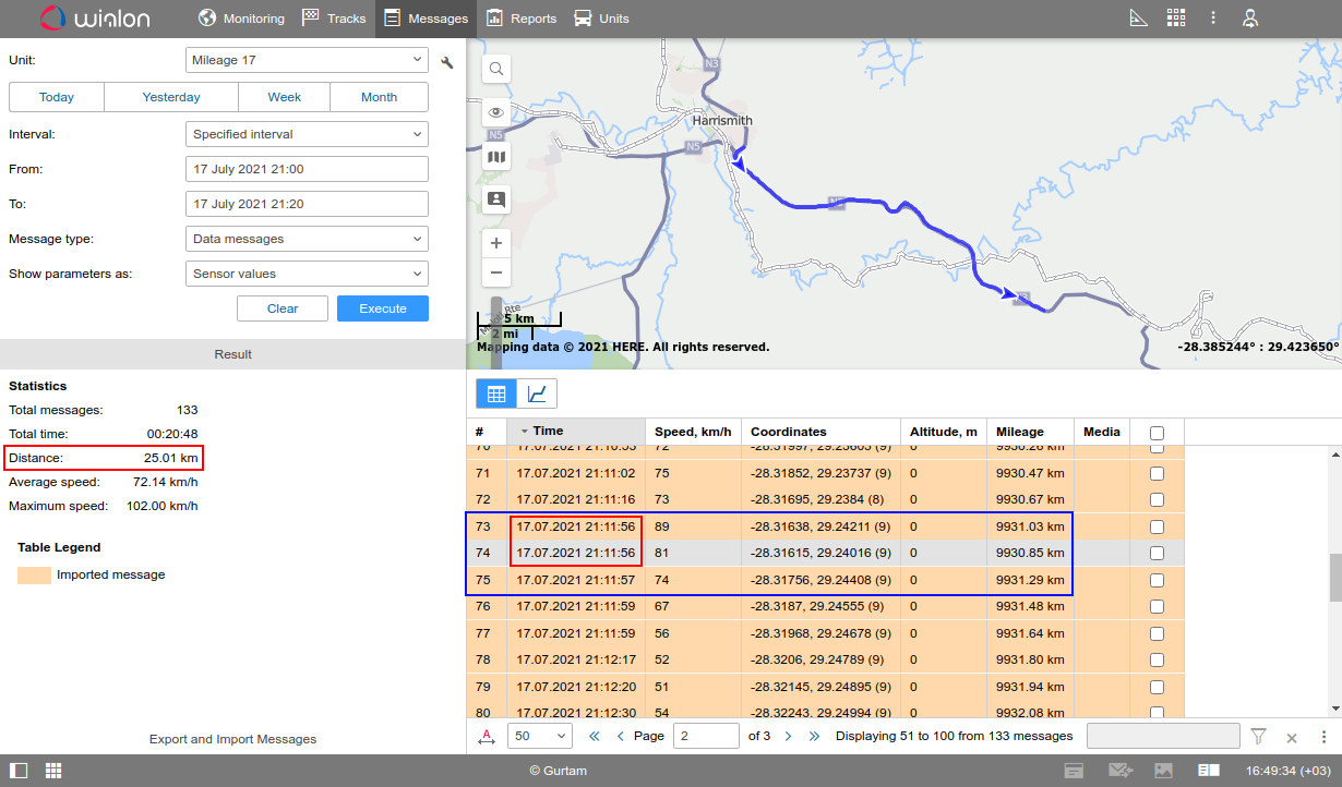

с. Messages with the same timestamp (the With overflow option disabled)
Messages may come with the same timestamp, disrupting the chronology, for example:

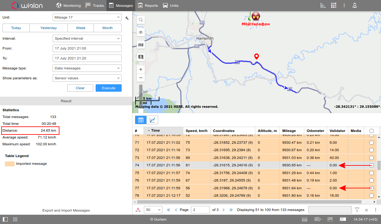

In general, in the picture above, the mileage looks correct — 25.01 km, in contrast to the previous example, where the error was obvious. However, if we take from the messages the initial value of the mileage sensor in the interval — 9917.81 km and the final value — 9942.44 km, subtract the difference, then we get the mileage — 24.63 km.
The difference is 0.38 km on a relatively small section of the track. The inaccuracy will grow with the increasing amount of data (number of trips). The reason for this error is, of course, the disruption of message chronology. The system expects the sensor value to increase. In the example, we see a drop from 9931.03 km to 9930.85 km and a subsequent increase to 9931.29 km. The mileage between messages with the sensor value 9930.85 km and 9931.29 km is recalculated, i.e., an extra 0.44 km is added.
Possible solutions:
  • Fix the problem on the hardware side;
  • Switch the mileage sensor to the Relative odometer type and apply validation.
In the example above, we managed to get more correct mileage values by switching the mileage sensor to the Relative odometer type with the added validation. The relative odometer sensor is based on a parameter represented as: mileage-#mileage. The validator is based on a parameter represented as: time-#time. The lower bound for the validator is 0, and the validation type is Not-null check. The mileage counter in the General tab is switched to Relative odometer.
After applying the validation, the mileage was 24.65 km. Messages with the same timestamp are excluded from the calculation.
