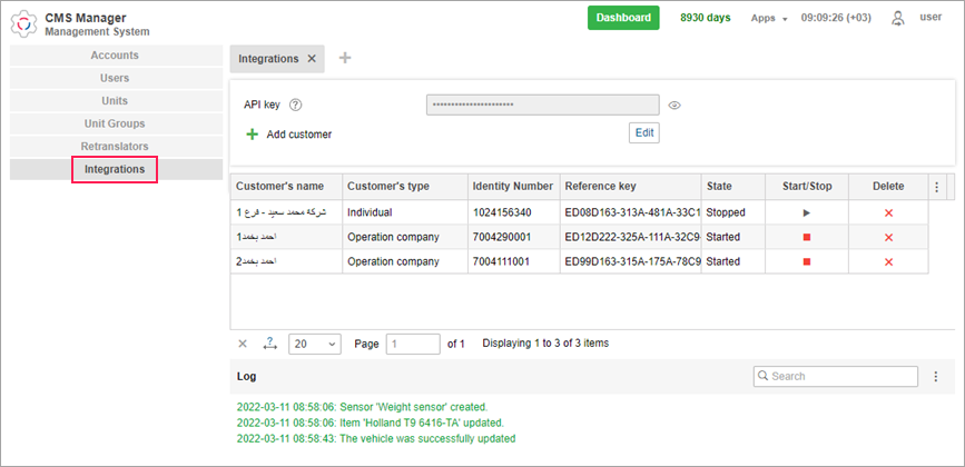

The Integrations section of the management system is designed for integrating Wialon with third-party services.
Here you can configure transmitting data from Wialon to the Wasl platform. This feature is available only to the top users and users with dealer rights for whom the Wasl Tracking Service as well as the Wasl and Drivers modules are activated. Besides, the Store registration time option should be enabled on the System tab in the administration system.
The process of configuring data transmission consists of the following stages:

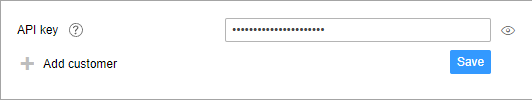

Specifying the API key
On the Integrations tab, specify the API key obtained after registering on the Wasl platform. To enter the key, click Edit, type it in the field, and click Save.
The specified key is used for all the customers you register.
Now you can proceed to register customers, drivers, and vehicles.
