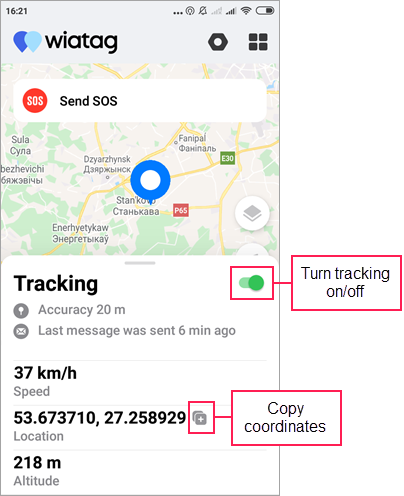

In this section, you can see data on the location of the mobile device. Here you can enable or disable sending this data to the server using the switch.
The full list of parameters sent by WiaTag devices is available at mos-glonass.com.
By default, most of the section is hidden. Expand the section to see all the information it contains:
- location accuracy;
- time when the last message was sent;
- speed of the unit;
- coordinates of the unit (to copy them, tap the icon
- altitude of the unit above sea level in meters.
If the icon is displayed in the section, the required settings or permissions are missing for the correct operation of the section. In this case, tap the section, follow the instructions and tap Continue in the window that opens.
For the ability to disable sending positional data to the server, the Allow the user to turn off tracking in the mobile application option should be activated in the Configurator web application.
