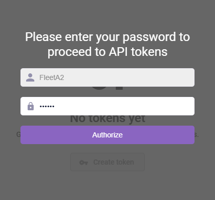

To open the page, click the user name in the navigation panel and choose the API tokens item. Enter your password and click Authorize.

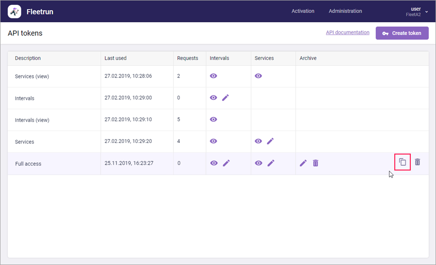

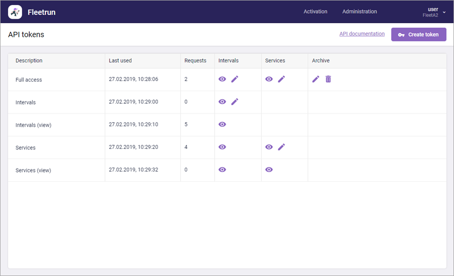

The page displays a table with the columns described below.
Column Description
Description The name of the token given by the user when creating it.
Last used The date and time of the previous usage. The API token is valid during 10 days since the date it was last used. After this period, it is deleted automatically.
Requests The number of requests by a token.
Intervals The access rights to intervals that the token possesses.
Services The access rights to services that the token possesses.
Archive The access rights that the token possesses to the archive.
When you hover the mouse cursor over the line with the token, the Copy to clipboard and Delete buttons appear.

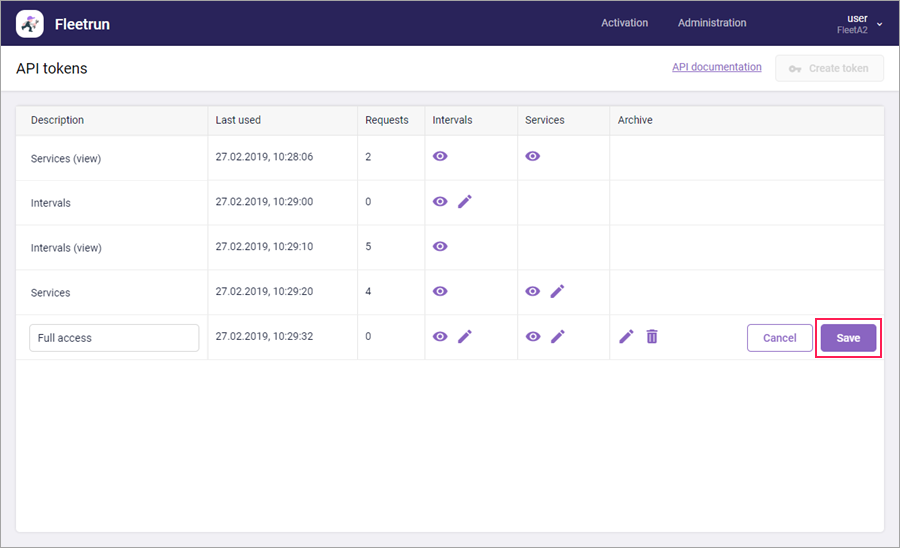

  1. Create a token in Fleetrun. To do this, press the Create token button in the upper right corner of the page. Enter a description and indicate access rights to intervals and/or services. Click Save.
  2. Copy the required token to the clipboard using the button  at the end of the line with its name.

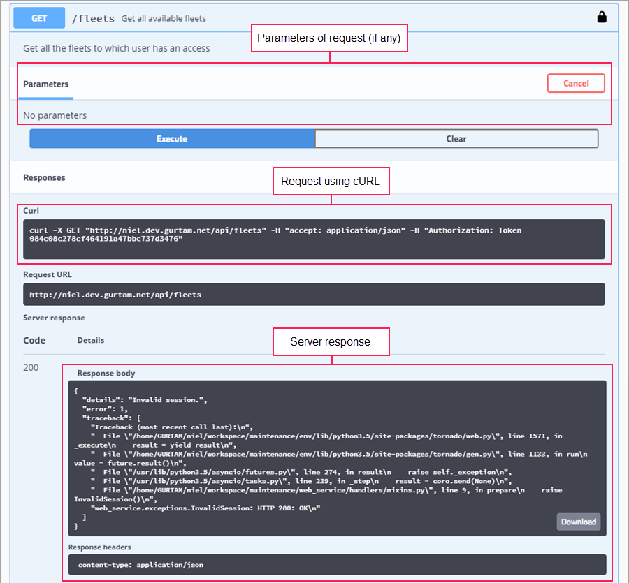

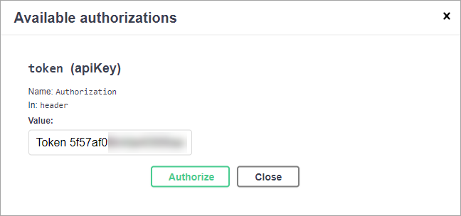

  3. Go to the Fleetrun API documentation site and open the authorization dialog box by clicking the icon  or the Authorize button. Paste the copied token into the Value field and press Authorize. Close the dialog box.

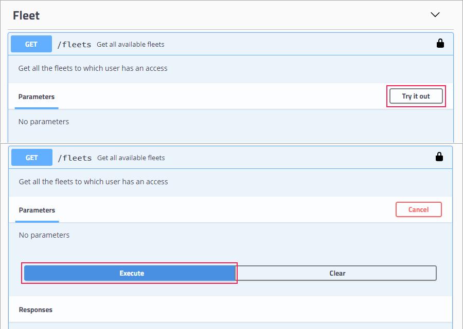

  4. After specifying the token, you can run queries. To do this, open any query and consecutively click Try it out and Execute.
  5. Besides describing queries and their parameters, the documentation allows you to change the query parameters, as well as view the response of the server.
