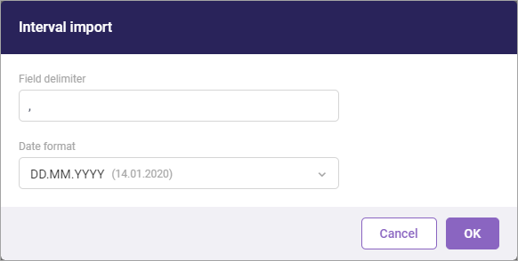

  3. Select the date format. For a CSV file, also specify the field delimiter used in it.

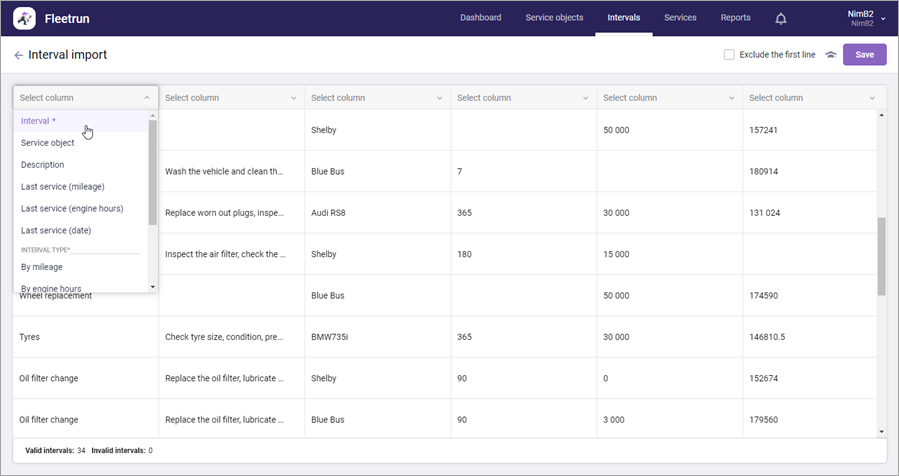

  4. In the table with the import results, indicate the names of the necessary columns. To do this, select the name of each column in the drop-down list above it. The Interval column and at least one column from the Interval type block (By mileageBy engine hoursBy time) are required. To cancel the selection, click on the icon .
    If you don’t select a name for a column, its content is not imported to the system.

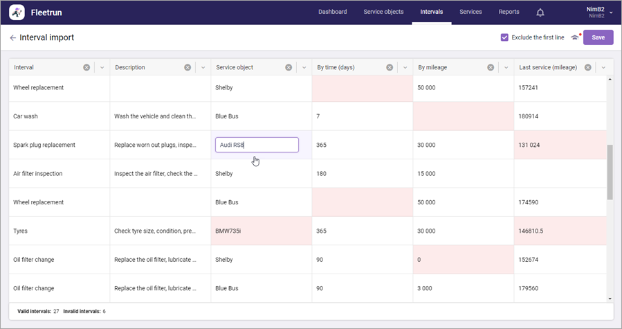

  6. Edit the data in the table, if needed. The cells with invalid data are highlighted in red. The intervals with such cells cannot be imported. To edit the data, click on the cell and type a new text into it. To save the text, click outside the cell.

When editing the data, consider the following:
  • The cells of the required columns should be filled in.
  • The name of the interval you want to import should not be the same as that of the existing one. The maximum allowed length is 128 characters.
  • In the Service object column, you can specify the names of only those units that are in the fleet (case sensitive). If several units of the fleet have the same name, all of them are assigned to the imported interval. The column shouldn’t contain driver or trailer names because the import of intervals is not available for them.
  • The description should not exceed 512 characters.
  • You should specify the frequency of the intervals, that is, fill in at least one of the By mileageBy engine hours, or By time columns. You can specify only one By time value for an interval (days, weeks, months, or years).
  • In the By mileage and By engine hours columns, you can indicate the values only in integer numbers. The value cannot be 0.
  • In the By time columns, you can indicate the values only in integer numbers. The maximum allowed value is 999.
  • To import the values of the Last service (mileage) and Last service (engine hours) columns, you should indicate the service object and the interval frequency by mileage or by engine hours respectively. The values of mileage and engine hours at the moment of the last service can be indicated only in integer numbers (the value can be 0). If you do not specify them, the values of mileage and engine hours at the moment of import are assigned to these parameters.
  • To import the value of the Last service (time) column, you should indicate the service object and the interval frequency by time. The date of the last service should not be later than the current one. If you do not specify it, the value of the date at the moment of import is assigned to it.
