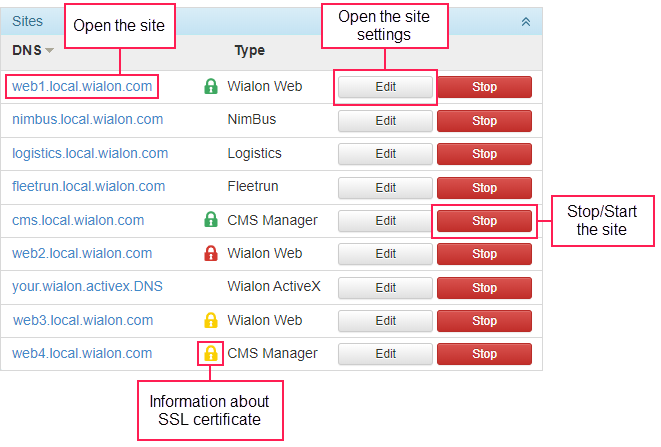

The Sites section is a table where the DNS and type of each site are specified. To open the required site, click on its DNS link.
To open the site settings, click on the Edit button next to its name.
To the right of the Edit button, there is a button to start/stop the site. If you stop the site, the users cannot log in to the system.

If a site works using the https protocol, a lock icon is displayed next to its name. In the tooltip of the icon, you can see the information about meeting the requirements for the certificate parameters and the name of the certificate authority (the Issuer line). The colour of the icon depends on the reliability of the SSL certificate.
Colour | Description |
The SSL certificate is valid because the requirements for all the parameters are fulfilled: the SSL certificate corresponds to the key, the MD5 hash of the certificate and the key is the same, the DNS of the certificate corresponds to that of the site, the validity period has not expired, the chain is complete. | |
The SSL certificate is self-signed (that is, not received from a certificate authority and loaded by the user, but generated by the server) or the certificate chain is not complete while the other requirements are fulfilled. In the latter case, you can try to restore the chain using the Fix button displayed in the SSL certificate line in the advanced settings. | |
The SSL certificate is invalid for one or several reasons: the SSL certificate does not correspond to the key, the MD5 hash of the certificate and the key is not the same, the DNS of the certificate does not correspond to that of the site, the validity period has expired. |
