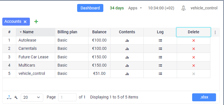

Deleting accounts
To delete an account, click on the icon red cross icon in its line (the Delete column).
A click on the icon opens a window in which you can see the types and names of all system objects that will be deleted with the account. To confirm the action, click OK.
If the account contains at least one unit, you must specify a reason for deleting it. You can select a reason from the list or provide your own (max. 500 characters). This information will be available to the user of the top account in the Unit deletion reason column in the trash.
If you delete an account, you automatically delete:
  • all micro-objects stored in the account resource (geofences and groups of geofences, jobs, notifications, drivers and groups of drivers, trailers and groups of trailers, passengers and groups of passengers, report templates);
  • all macro-objects belonging to the account (subordinate accounts, resources, users, units and groups of units, retranslators, routes).

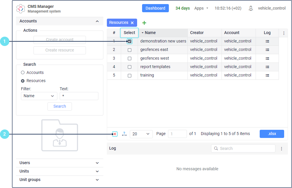

Deleting resources
To delete a resource, select it in the table (the Select column), click on the icon red cross icon in the tool panel, and confirm the action in the window that opens.
If you delete a resource, you automatically delete all micro-objects stored in it:
  • geofences and groups of geofences;
  • jobs;
  • notifications;
  • drivers and groups of drivers;
  • trailers and groups of trailers;
  • passengers and groups of passengers;
  • report templates.
