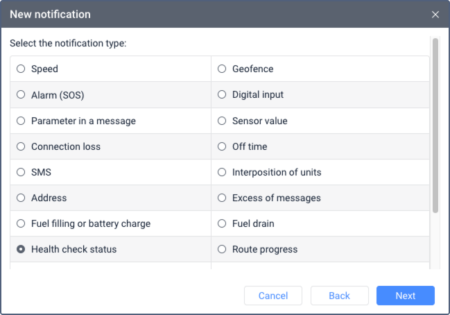

Below are all the possible notification types and the parameters available for them.

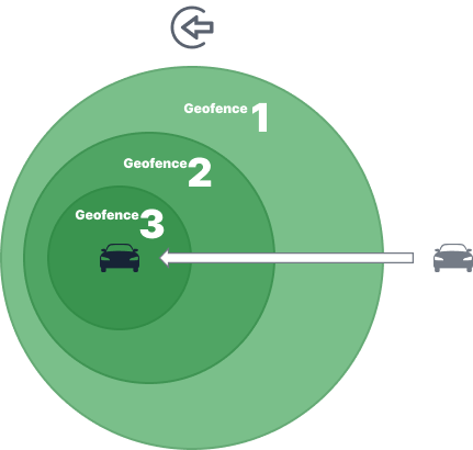

Example. Geofence 1, Geofence 2 and Geofence 3 are selected in the notification settings. When the unit enters Geofence 1, the notification is triggered. It will also be triggered if the unit enters Geofence 2 or Geofence 3. In addition, the notification will be triggered if the geofences don’t overlap and the unit enters any of them.
AND
The notification is triggered when the unit is in all the selected geofences at the same time.
Example. Geofence 1, Geofence 2 and Geofence 3 are selected in the notification settings. Geofence 3 is inside Geofence 2 and Geofence 1. When the unit is in Geofence 3 and therefore in all the other geofences at the same time, the notification is triggered.

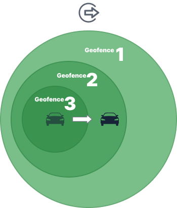

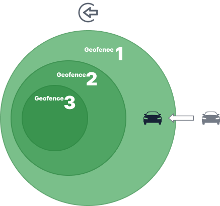

Logical operators for a notification with the “Outside geofence” control type
If the notification controls the exit of a unit from a geofence, the OR and AND operators act as follows.
Logical operatorDescription
OR
The notification is triggered when the unit leaves any of the selected geofences if it previously has been in all of them at the same time.
Example. Geofence 1, Geofence 2 and Geofence 3 are selected in the notification settings. Geofence 3 is inside Geofence 2 and Geofence 1. The unit is in Geofence 3 and therefore in all the three geofences at the same time. When it leaves Geofence 3 but still remains in Geofence 2 and Geofence 1, the notification is triggered. The notification is also triggered if the unit moves from Geofence 3 to Geofence 1 or leaves all the geofences at once. If the unit was in Geofence 2 or Geofence 1 and has left them, the notification won't be triggered.
AND
The notification is triggered when the unit leaves all the selected geofences.
Example. Geofence 1, Geofence 2 and Geofence 3 are selected in the notification settings. Geofence 3 is inside Geofence 2 and Geofence 1. The unit is in Geofence 1. After the unit leaves Geofence 1, it is not in any of the three geofences, so the notification is triggered. In addition, the notification is triggered if the geofences don't overlap and the unit leaves any of them.

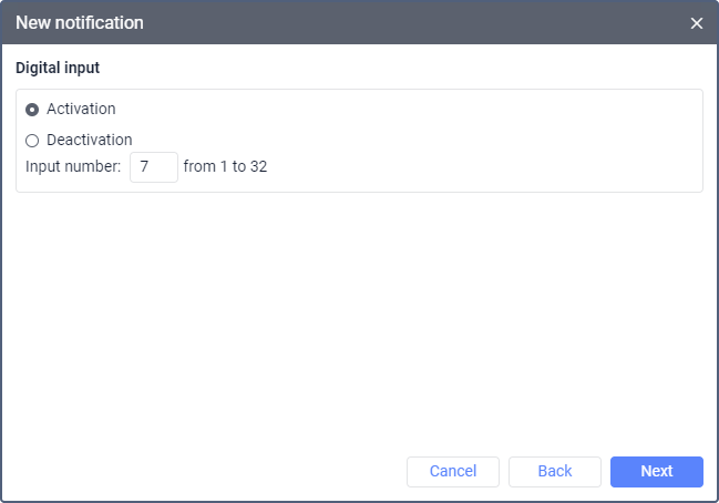

Digital input
A notification of this type is triggered if a digital input of the device is activated or deactivated. To configure the notification, specify the input number on the Activation or Deactivation tab, respectively.
If the message doesn’t have the I/O parameter, the io_n parameter is analyzed.

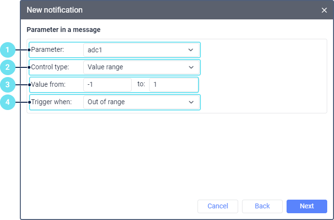

Using this type of notification, you can control sensor parameters in messages. It allows controlling parameters sent by the device and doesn’t include the control of virtual parameters (sats, speed, lat, and so on).
To configure a notification of this type, follow these steps:
  1. In the drop-down list, select the parameter you want to control.
    For parameters of the in and out types, you can control only the availability or lack of the parameter.
  2. Select one of the available control types:
    • Value range. Allows specifying the minimum and maximum values of the parameter and select the activation type. For this type, follow steps 3 and 4.
    • Text mask. Allows controlling text parameters. For this type, specify the text mask in the Mask field using special characters (* and ?).
    • Parameter availability. Allows controlling the availability of the selected parameter in messages.
    • Parameter lack. Allows controlling the lack of the selected parameter in messages. For the notification to be activated when the parameter appears or disappears from messages, select the Only when state changed option in the Generate notification parameter.
  3. Specify the minimum and maximum values of the parameter. If you want the notification to be activated when the value is not equal to 0, specify 0 in both fields and select the Out of range activation type.
  4. Select the activation type:
    • In range. The notification is triggered when receiving values which fall in the specified range, including the values specified as minimum and maximum ones.
    • Out of range. The notification is triggered when receiving values which don’t fall in the specified range.

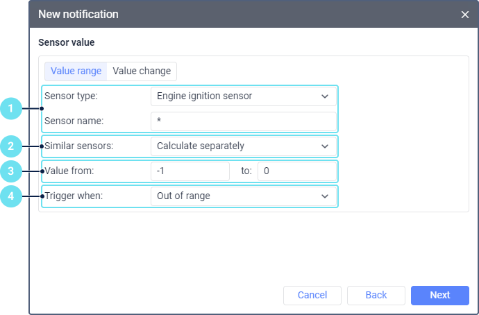

Sensor value
For a notification of this type, two control methods are available:
  • Value range. Allows specifying a range of sensor values to control whether the received values fall in it or not.
  • Value change. Allows specifying one value to control whether the received values exceed it or not.
The Sensor value notification will not trigger in the following cases:
  • the notification is used to control the values of the sensors which use parameters from previous messages;
  • the received sensor value does not fall within the interval set in the Upper bound and Lower bound fields in the calculation table. Such values are invalid and are not considered equal to 0.
For the Value range method, follow these steps:
  1. In the drop-down list, select the sensor type and/or in the Sensor name field, specify the name mask using special characters (* and ?).
  2. In the Similar sensors drop-down list, select one of the available options:
    • Sum up values. The values of all sensors of the selected type and/or sensors with the same name mask are summed up. Thus, the sum of all values is taken into account before the notification is activated.
    • Calculate separately. The values of all sensors of the selected type and/or sensors with the same specified name mask are controlled separately.
  3. Specify the minimum and maximum values of the sensor. If you need to control a specific value, enter the same number in both the Value from and to fields, for example, from 1 to 1.
    • In range. The notification is activated when receiving values which fall in the specified range, including the values specified as minimum and maximum ones.
    • Out of range. The notification is activated when receiving values which don’t fall in the specified range.
For the Value change method, open the same-name tab on the right and follow steps 1 and 2 from the instruction above. In the Delta field, specify a value to trigger the notification when it is exceeded.
Example. The notification should be triggered when the value changes to 1. To do this, 0.9 must be specified in the field.
The sensor values can be increased or decreased because the specified delta is compared with the module (for example, |12 − 10| = 2 and |10 − 12| = 2).

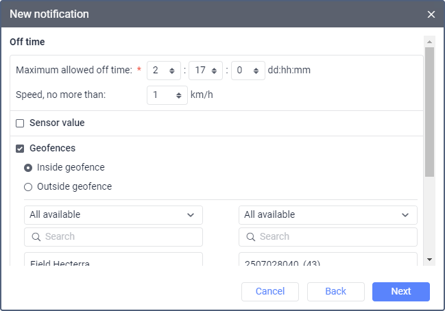

To configure this notification, adjust the following settings:
Setting Description
Max allowed off time Specify for how long a unit can remain stationary before the notification is triggered. This value can’t exceed 30 days.
Speed, no more than Set the speed threshold below which the vehicle is considered stationary. It is recommended to set this value to 1–5 km/h to account for potential GPS inaccuracies.
Example. The Maximum allowed off time is set to 15 minutes and Speed, no more than, is set to 3 km/h. In this case, the notification will be triggered if the vehicle speed remains below 3 km/h for 15 minutes consecutively. If the vehicle speed exceeds 3 km/h, the 15-minute timer resets to zero and begins counting again when the speed falls back below 3 km/h.
If the Sensor value option is activated, the notification is triggered only if all the specified conditions are met: off time duration, speed, and the sensor value. For example, you can receive notifications when the unit is parked with the engine or attachments running. This option is configured in the same way as the notification type of the same name.
Also, whether the unit is inside or outside a certain geofence can be an additional condition for triggering the notification. For this purpose, enable the Geofence option and configure the settings described in steps 1–4 in the same-name notification type.

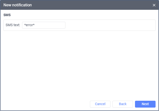

SMS
A notification of this type informs the receiver of getting an SMS message. An asterisk (*) is specified in the SMS text field by default, which means that the notification works for any SMS message. You can specify a mask of a message text so that the notification is triggered only if an SMS message contains the specified text. This may be useful, for example, if the device sends an SMS message with a certain content in case of malfunction.

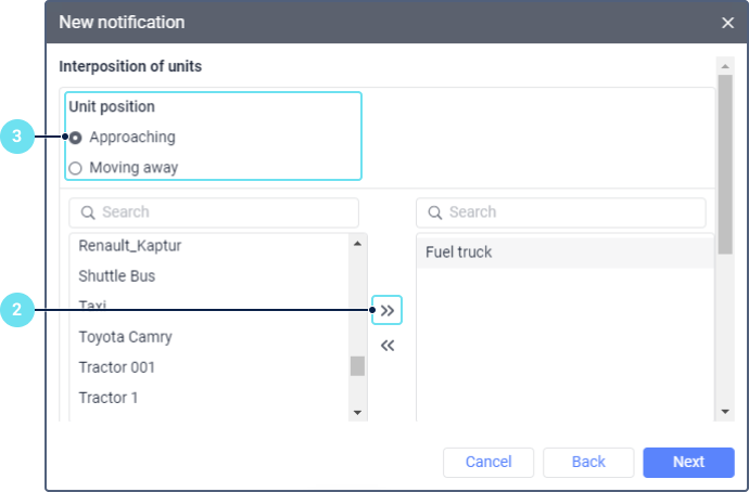

Interposition of units
Using notifications of this type, you can monitor whether the units are approaching or moving away from one another.
To configure a notification, follow the steps below.

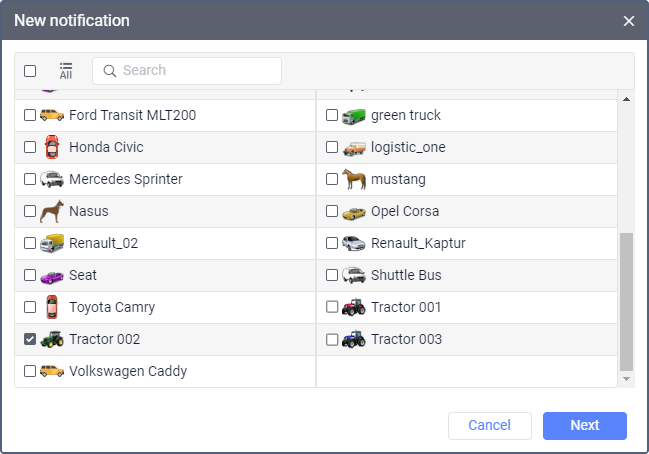

  1. Select the unit or units you want to control from the list.
    The triggered notification indicates that the unit selected in this step approaches or moves away from the unit selected in step 2.
  2. Move to the right side of the window the unit or units that affect the notification triggering taking into account the distance towards them. To find the required unit, use the dynamic search above the list.
  3. Select when you want to be notified: when the unit selected in step 1 approaches another unit or when it moves away from another unit.

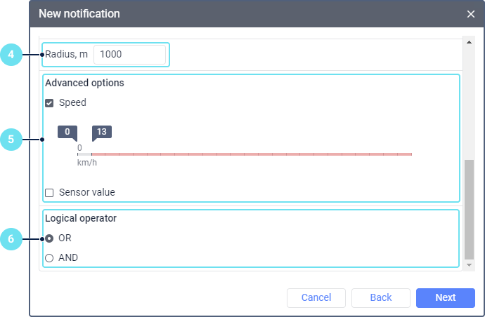

  4. In the Radius field, specify the distance between the units, when the notification should be triggered if the distance decreases or increases.
  5. If necessary, set additional conditions for the notification: speed of the unit selected in step 1 and its sensor value. The latter option is configured in the same way as the notification type of the same name.
  6. In the Logic operator section, select how the specified conditions should be applied in case several units are selected in step 2. Below, you can read about how the AND and OR operators work.
Logical operators “AND” and “OR”
If the notification tracks the approach of a unit to several other units, the OR and AND operators work as follows.
OR
The notification is triggered when the unit selected in step 1 of the guide above (the main unit) approaches any of the units selected in step 2 (the other units). In order for the notification to be triggered, the distance between the main unit and one of the others must be less than the distance specified in the Radius field.
Example. The notification tracks the approach of Unit 1 to Units 2 and 3. The Radius field is set to 1000 meters. Unit 1 is approaching Unit 3. When the distance between them is 999 m, the notification is triggered.
AND
The notification is triggered when the unit selected in step 1 of the guide above (the main unit) approaches all the units selected in step 2 (the other units) and the distance between them becomes less than the value specified in the Radius field. That is, if the main unit is approaching only some of the others at the required distance, the notification is not triggered.
In the notification text, the names of all the units approached by the main unit are shown in place of the %OTHER_UNIT% tag.
If the notification tracks the distancing of a unit from several units, the OR and AND operators work as follows:
OR
The notification is triggered when the unit selected in step 1 of the guide above (the main unit) moves away from any of the units selected in step 2 (the other units). For the notification to be triggered, the distance between the main unit and the other units must first be less than the distance specified in the Radius field, and then become greater than that value.
AND
The notification is triggered when the unit selected in step 1 of the guide above (the main unit) moves away from all the units selected in step 2 (the other units). That is, if the main unit is moving away only from some of the others, the notification is not triggered. Also, for the notification to be triggered, the distance between the main unit and the other units must first be less than the distance specified in the Radius field, and then become greater than this value.
In the notification text,  the names of all the units from which the main unit has moved away are shown in place of the %OTHER_UNIT% tag.

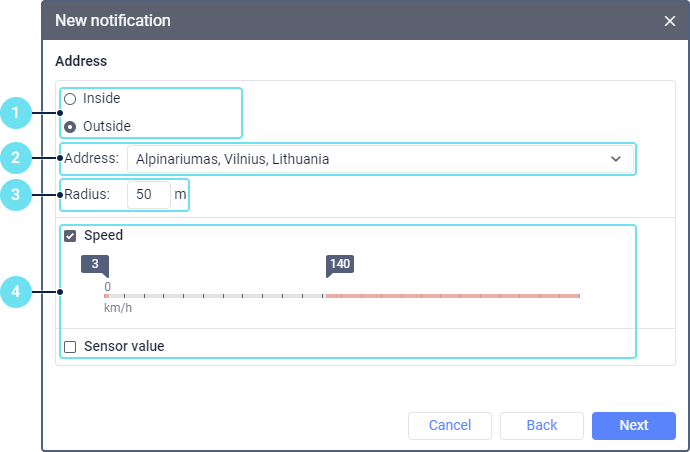

  1. Select when the notification should be triggered: when the unit is at the specified address (Inside) or in any other place (Outside).
  2. Start typing the address in the Address field (city, street, house number, etc.) and select the suitable option from the list.
  3. Specify the radius of this point in the Radius field.
  4. If necessary, specify an additional condition: speed and/or sensor value.

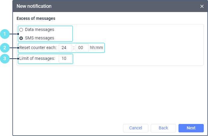

Excess of messages
Using notifications of this type, you can control the number of messages received from the unit during a certain time interval. These can be regular messages with data (coordinates, sensor values, etc.) or SMS messages.
  1. Select the type of messages: data messages or SMS messages.
  2. In the Reset counter each field, specify the time interval for which you want to set a limit on messages.
  3. In the Limit of messsages field, specify the number of messages after exceeding which the notification should be triggered.
In the example from the image above, the notification is triggered if 10 or more SMS messages are received from the unit within 24 hours.

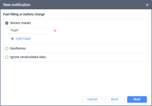

In the Sensor masks option, you can specify one or several masks of the sensors that should be used for detecting fuel fillings or battery charges and their volume.
The notification is triggered for each fuel level sensor or battery level sensor individually.
If the Ignore recalculated data option is enabled, the notification is received only once after a fuel filling or battery charge is detected.

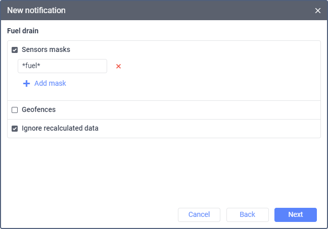

Fuel drain
Prerequisites
The Calculate data by the sensor option must be enabled in the settings of the fuel level sensor.

Health check status
Prerequisites
Before setting up the Health check status notification, you need to have:
The Health check status notification allows monitoring the state of the unit device. You can configure the notification triggering when the device status changes to the following statuses.
Status Description
Healthy The notification is triggered when the unit device doesn’t meet any criteria configured on the Health check tab.
Need attention The notification triggers when the incident that meets one or more criteria is registered for the unit device. Enable the Trigger notification for each incident option to generate a notification each time when an incident is registered within the Need attention status.
Unhealthy The notification triggers when all the configured criteria on the Health check tab are met.
The text of the triggered notification indicates the reason for the device status change.
To learn about the past device status changes, you can run the Health check incidents report table.

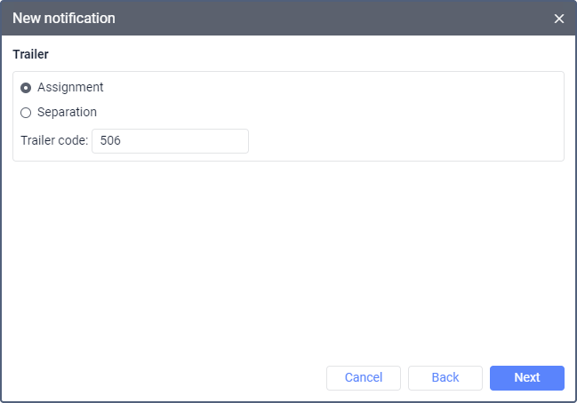

Trailer
Notifications of this type allow you to monitor when trailers are assigned to the unit or separated from it. You can configure them in the same way as notifications of the Driver type.

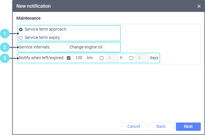

Maintenance
Prerequisites
The creator of the resoure in which the notification is stored needs the View service Intervals access right to the unit.
Notifications of this type are used for the services created on the Service intervals tab of the unit properties.
To configure a maintenance notification, follow these steps:
  1. Select when you want to receive notifications: before or after the service term (the Service term approach and Service term expiry buttons, respectively).
  2. In the Service intervals field, specify the name of the service for which you want to configure the notification. To specify several names, use the name mask. If the symbol * is specified in the field, the notification is applied to all created intervals.
  3. To be notified of the service term approach, specify how many kilometers, hours, and/or days should be left before the beginning of the service term so that the notification is triggered. To be notified of the service term expiry, specify how many kilometers, hours, and/or days should pass after the expiration of the service so that the notification is triggered.
    Example. Vehicle maintenance must be performed every 15,000 km, so a service interval by mileage with a value of 15,000 km has been created for the unit. Also, a notification of the approaching deadline with a value of 1,000 km has been configured. Assuming that the mileage is counted from 0, the notification will be triggered when the mileage is 14,001 km.
The maintenance notification is triggered only once when at least one of the conditions specified in step 3 is fulfilled.
After performing maintenance work, register it using the event registrar or in the unit properties so that the notification term is counted again.
Notifications of this type are not triggered if:
  • you specify a name of at least one overdue service when creating the notification;
  • the unit for which the notification is created doesn’t have any messages with location data.
Also, if the notification is created for several or all service intervals, it will no longer be triggered when at least one of the services becomes overdue.
