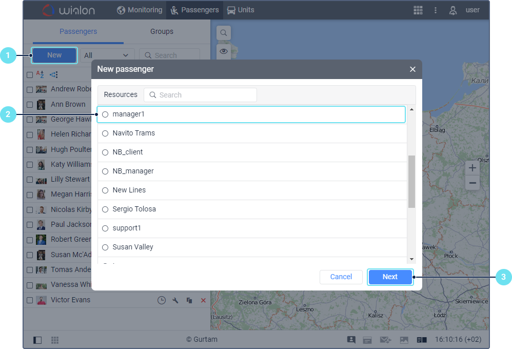

  1. Click New on the Passengers tab.
  2. Select the resource in which you want to create a passenger if you have more than one resource available.
  3. Click Next.

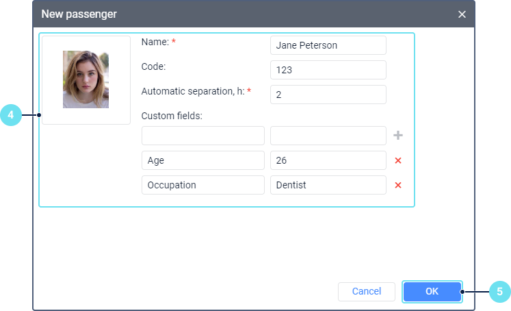

  4. Specify the properties of the passenger: name, automatic assignment and separation code, and specify the time after which the passenger should be separated from the unit automatically (from 0 to 99 hours, 10 is specified by default). If 0 is specified, automatic separation is disabled. See Assignment and separation algorithm. If necessary, add custom fields and upload a PNG, JPG, GIF or SVG image. The properties of a passenger, except for the Automatic separation option, are similar to those of a driver.
  5. Click OK.
