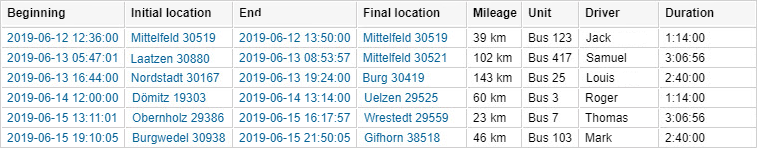

The Assignments table can include the time and location of the passengers boarding/leaving a vehicle, name of the unit used by passengers, duration of a trip, etc.
Column | Description |
Passenger | The name of the passenger assigned to a unit (only in the report on the group of passengers). |
Beginning | The time a passenger was assigned to a unit. |
Initial location | The location of the passenger when assigned to a unit. |
End | The time the passenger was separated from a unit.If a passenger is automatically separated from a unit after the time specified in the Automatic separation field in the passenger properties expires, the assignment interval is considered incomplete. In this case, the value in the End column depends on the Incomplete interval option settings. |
Final location | The location of the passenger when separated from a unit. If the separation happened automatically and the Show and mark as incomplete parameter is selected in the table as the action for an incomplete interval, a dash is shown in the field. |
Mileage | The distance the passenger travelled by the time they were separated from a unit. |
Unit | The name of the unit to which the passenger was assigned. |
Driver | The name of the driver of the unit to which a passenger was assigned. |
Duration | The time the passenger spent on the trip (time between the assignment and the subsequent separation). In case of an automatic separation, 0:00:00 is indicated in this field. |
