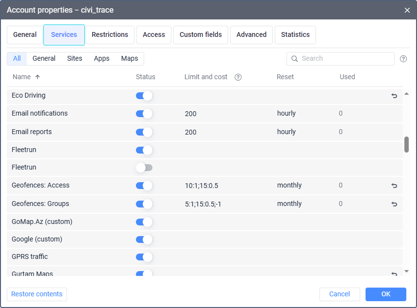

To work with the Services tab, you should have the following access rights to the account:
  • View detailed object properties. To see the tab.
  • Manage account. To specify the limit and cost of services.
The tab displays all the services available for the account. The list of services depends on the billing plan selected for the account and the activated modules. Here you can enable and disable services for the account as well as set their limit and cost.

Service settings
Depending on the selected filter, the list of services can consist of the following columns:
Column Description
Name The name of the service. See the full list of services and their description here.
Status The state of the service. Click on the button to disable or enable the service.
The deactivation of a service in a billing plan leads to its automatic deactivation in the account to which this plan is assigned. However, if the state of the service is additionally changed in the properties of the account, then it is given priority.
An account user does not have access to services that are disabled in a parent account.
To reset the default status, click on the icon restore in the service row. The default status is taken from the billing plan assigned to the account. The icon isn’t active unless you have changed the status or edited the values in the Limit and cost column.
Limit and cost In the Limit and cost column, you can specify the maximum quantity or quantity and cost of the service. See the examples and how to fill in the field correctly.
The values of the Limit and cost field can be greater than those in the billing plan properties, but not greater than the values from the Limit column.
The default values are taken from the billing plan assigned to the account. To reset the default values, click on the icon restore in the service row. The icon isn’t active unless you have changed the status or edited the values in the Limit and cost column.
Reset Here you can select how often the specified service limit should be reset: hourly, daily, weekly, or every calendar month (monthly). After the end of the selected period, the value in the Used column is reset to zero.
Example. The Limit and cost field specifies 10, and the Reset field specifies daily for the SMS messages service. In this case, the user can send no more than 10 messages each day.
Used This column shows how many objects (units, drivers, etc.) are already created in the account and in its subordinate accounts, if any. For uncountable types of services, such as SDK, Units: Eco driving, and so on, nothing is shown in the column.
The value resets after the period selected in the Reset column.
You can sort the services by their name and status by clicking on the column heading.

Filling in the “Limit and cost” field
The Limit and cost field supports several input formats. You can enter a single number (limit) or an expression (limit and cost). The field also allows expressions disabling the service after a certain limit is reached.
Specifying the limit
A single integer number in the field stands for the maximum quantity for the service. For example, 200 in the Units: Access service means that at most 200 units can be created.
A single fractional number is processed by the system as the cost of the service. For example, 6.5 for the Units: Access service means that the cost of each unit is 6.5 USD (or other currency in use).
You can set the maximum quantity which is refreshed after a certain period of time. To do this, enter an integer number and select the period in the Reset column.
Example. The entry 100 in the Units: Access service with the option monthly selected in the Reset column means that no more than 100 units per month can be created in the account.
Specifying the limit and cost
To specify the quantity and cost, enter the expression in the Limit:cost format, where Limit is an integer number that means the maximum quantity at this price and cost is the price per unit. You can specify different costs based on quantity by using multiple Limit:cost pairs separated by a colon.
The expression can have the following format:
limit:cost;limit:cost;limit:cost
Example. The entry 1:0;5:1;20:0.5 for the Unit: Access service means:
  • The first unit is free.
  • Units 2 to 5 cost 1 USD each.
  • Units 6 to 20 cost 0.5 USD each.
  • Any additional units are free of charge, regardless of quantity.
If you specify the cost without the limit or the limit without the cost within an expression, the system completes the expression with the missing value based on the first Limit:cost pair. If a value is missing in the first pair, the system substitutes it with 0.
Disabling the service at reaching the limit
If you need to disable the service when a certain paid limit is reached, add -1 at the end of the expression.
Example. The entry 1:0;5:1;20:0.5;-1 means that the service is disabled after 20 units are created.
