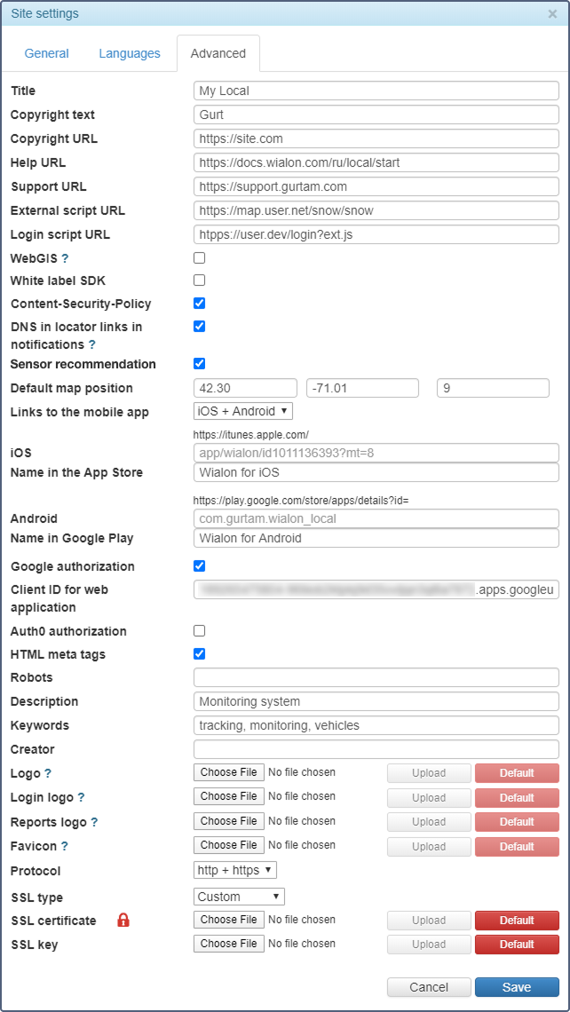

On this tab, depending on the type of the site, you can configure different parameters related mainly to the personalization of the sites. The settings of different types of sites are described below.
Wialon Web
For the sites of this type, you can change the parameters specified below.
Parameter Description

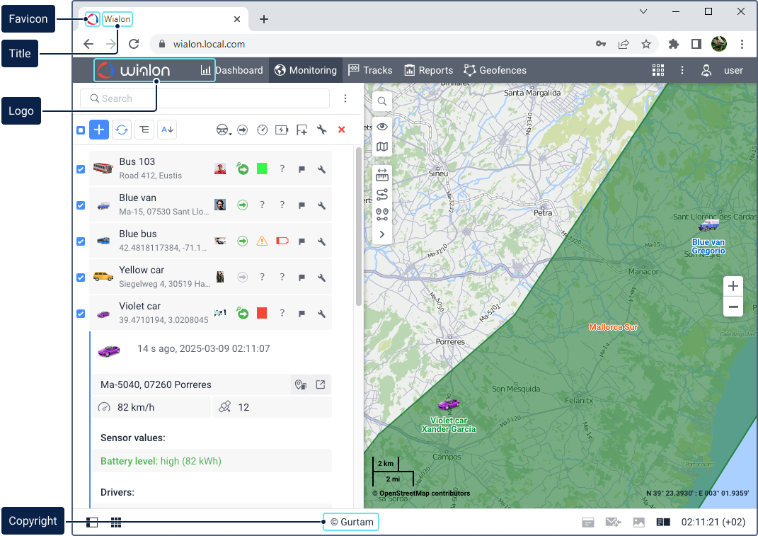

Title The title of the site.
Copyright text The text that is displayed as copyright. It is applied only if you fill in the Copyright URL field.
Copyright URL The address of the site where the copyright link leads. It is applied only if you fill in the Copyright text field.
Help URL The address of the site with the documentation. If the field is empty, there is no documentation.
Support URL The address of the technical support site.
External script URL The address of a third-party script that should be connected to the monitoring site.
Login script URL The address of the script that should be used at login.
WebGIS The option that allows renaming Gurtam Maps to WebGIS.
White label SDK If this option is enabled, the part wialon/ajax.html in API requests for Wialon sites is replaced with api. At the same time, individual SDK requests can be generated both in the old form according to the official SDK documentation (with the part wialon/ajax.html) and in the new form (replacing the part wialon/ajax.html with api).
Content-Security-Policy The option for activation of the Content-Security-Policy header.
DNS in locator links in notifications The option that allows using the DNS of the site in locator links (“%LOCATOR_LINK%” tag) which are used in the notifications of the Wialon monitoring system and Logistics. You can select only one DNS at a time. Restart Wialon Local to apply the setting.
Sensor recommendation This option allows using the sensor recommendation service. When it is enabled, the list of the most used sensors is available when you create sensors in the unit properties.
Default map position The position of the map after logging in to the monitoring system. You can indicate the latitude and the longitude of the point on which the map should be centered and the scale (from 1 to 18).
Link to the mobile app The option that enables the display of the buttons that lead to the download page of the mobile application. Available options:
  • No
  • iOS + Android
  • iOS + Huawei
  • Android + Huawei
  • iOS + Android + Huawei
  • iOS
  • Android
  • Huawei
Further, in accordance with the selected option, you can specify the link (links) to your application (applications) and the name of the application in AppStore and/or Google Play.
Google authorization If this option is enabled, you can connect your Wialon Local account with a Google account in the user settings of the monitoring system, and later use it to log in. See a detailed guide.
Client ID for web application In this field, you should specify the client ID from the Google Cloud Console service if the Google authorization option is enabled (see above).
Auth0 authorization If this option is enabled, you can use the third-party service Auth0 to log in to the monitoring system. To complete the configuration, it is required to fill in the fields below.
Service name on the login button The name specified here substitutes for N in the phrase Login via N account, which is shown on the button on the login page.
Your service name Your service name which is used in Wialon Local to configure Auth0 authorization.
Auth0 client ID The client ID which is used in the Auth0 service.
Auth0 domain The URL address of the authorization point in the Auth0 service.
HTML meta tags The option that enables using HTML meta tags. You can add the information for the following meta tags: Robots, Description, Keywords, Creator.
Logo The logo of the monitoring site. You can use a PNG or SVG image which does not exceed 172×30 pixels in size.
Login logo The logo that is displayed on the login page. You can use a PNG or SVG image. The size requirements depend on the New login page option in the general site settings. If the option is enabled and the new design of the login page is applied, the image size mustn’t exceed 320×72 pixels; if the option is disabled, the size mustn’t exceed 314×80 pixels.
Report logo The logo that is displayed in the exported report (files in HTML, PDF). You can use a PNG image which does not exceed 140×30 pixels in size. This option allows applying only one logo (the last uploaded one) to all sites of the Wialon Web type, if there are several of them. It is advisable to set logos for reports and assign them to billing plans in the Logos in reports section.
Favicon The icon of the site, which is shown next to the title. You can use an ICO image which does not exceed 16×16 pixels in size.
Protocol The protocol used (http, http + https, https). For the https protocol, you can add an SSL certificate and an SSL key. For an SSL certificate, indicate its type (Custom, Let’s Encrypt, or Self-signed). In case of selecting Let’s Encrypt or Self-signed, you do not have to upload the certificate yourself because it is generated automatically.
To return to the original view of the monitoring site, clear all the text fields on this tab and reset the settings of the images by clicking on the Default button.
Certain elements of the interface are displayed below.

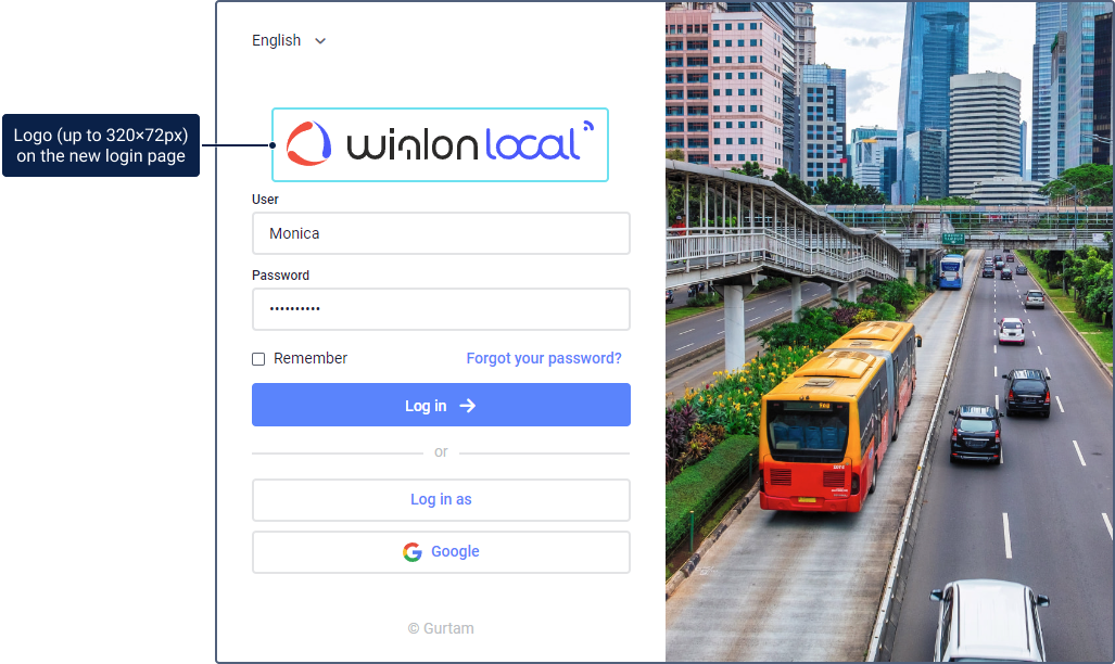

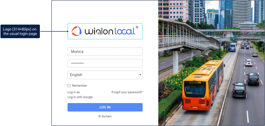

New and usual login pages
In the images below, you can see the usual login page and the new one.
Usual login page
New login page

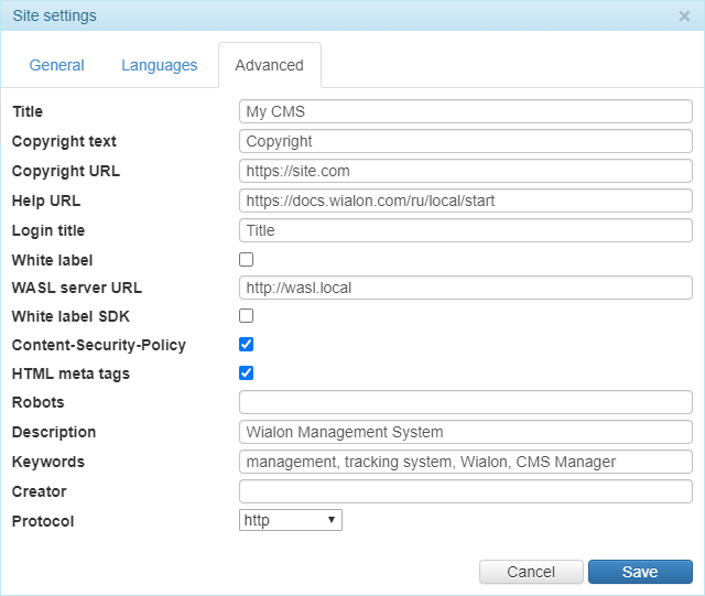

CMS Manager
The parameters available in the advanced settings of the CMS Manager site are described below.
ParameterDescription
TitleThe title of the site.
Copyright textThe text that is displayed as copyright. It is applied only if you fill in the Copyright URL field.
Copyright URLThe address of the site where the copyright link leads. It is applied only if you fill in the Copyright text field.
Help URL
The address of the site with the documentation. If the URL is not specified, CMS Manager is redirected to the documentation in accordance with the language of the application interface. To disable the link to the documentation, enter the value skip in the field.
Login title
The title that is shown on the login page (it is required to additionally activate the White label option).
White labelThe option that removes the logo from the login page.
Wasl server URL
This setting is used for configuring data sending from Wialon to Wasl. Here you should indicate the DNS specified in the general settings of the Wasl site preceded by the protocol prefix http or https
If you change the protocol for the DNS of the Wasl site, you should change the protocol prefix for the Wasl server URL as well.
In case of any questions, contact technical support.
After that, you can proceed to the configuration in the management system
White label SDKThe option that allows hiding Wialon mentions in SDK requests.
Content-Security-PolicyThe option for activation of the Content-Security-Policy header.
HTML meta tags
Protocol
The protocol used (http, http + https, https). For the https protocol, you can add an SSL certificate and an SSL key. For an SSL certificate, indicate its type (Custom, Let's Encrypt, or Self-signed). In case of selecting Let's Encrypt or Self-signed, you do not have to upload the certificate yourself because it is generated automatically.
After making changes, it is recommended to clear the cache and restart the site.

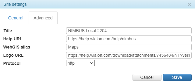

NimBus
The parameters available in the advanced settings of the NimBus site are described below.
Help URLThe address of the site with the documentation.
WebGIS aliasWebGIS name within the application.
Logo URL
The address of the image shown on the application login page and in the application itself next to its name. The https protocol should be used for the address. The aspect ratio of the image should be 1:1.
Protocol
To work using the https protocol, the site (Wialon Web or CMS Manager) indicated in the Base URL field on the General tab is also required to work with it (i.e. in the Protocol field, either http + https or https should be selected).
After making changes, the site becomes unavailable for a period of up to 10 minutes.

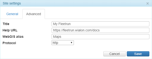

The parameters available in the advanced settings of the Fleetrun site are described below.
Protocol

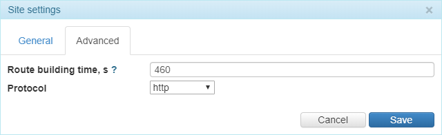

Logistics
The parameters available in the advanced settings of the Logistics site are described below.
Route building time, sThe timeout of executing requests for creating and optimization of routes in the application.
Protocol
To work using the https protocol, the site (Wialon Web or CMS Manager) indicated in the Base URL field on the General tab is also required to work with it (that is, either http + https or https should be selected in the Protocol field).

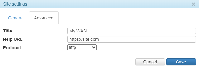

Wasl
The advanced settings of the Wasl site don’t influence the available functions. Filling in the fields is optional.
