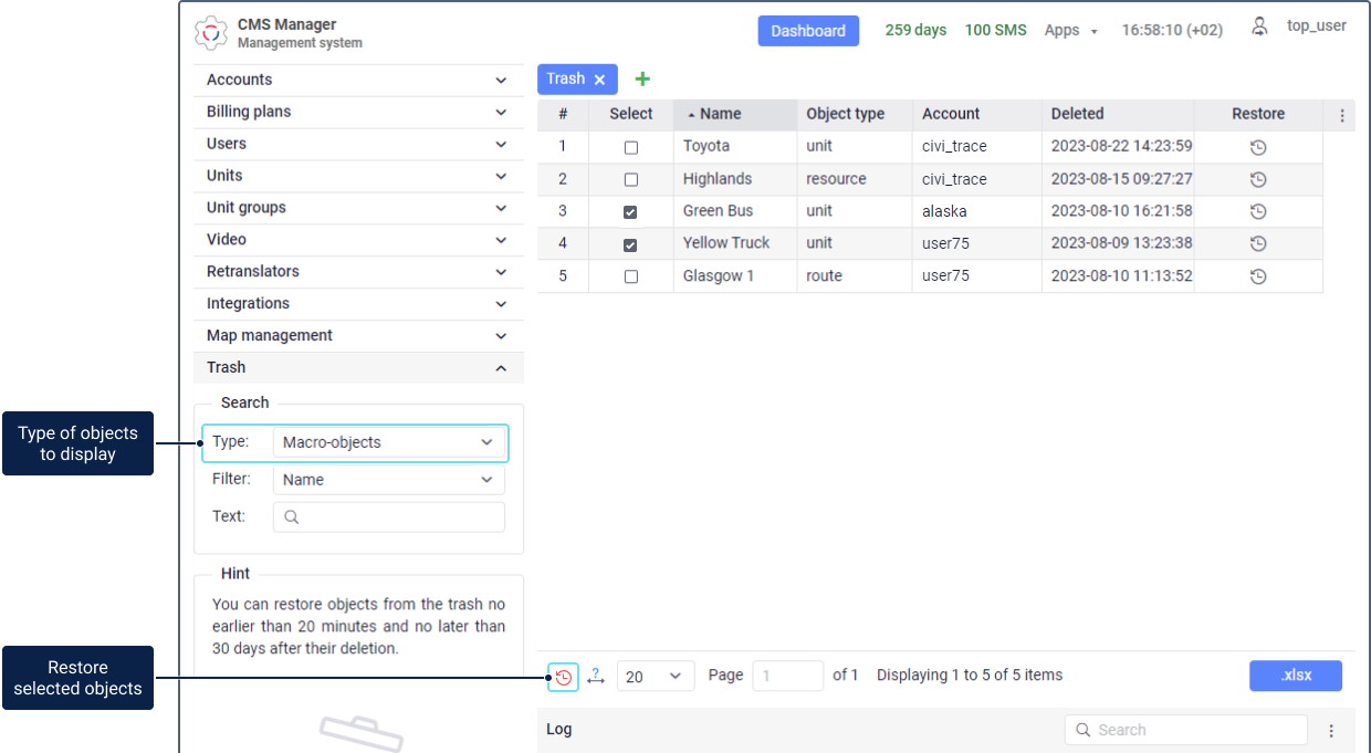

To quickly find the required object in the trash, use filtering. To do this, select the necessary filtering criterion in the Filter field and start typing your request in the Text field.
If necessary, you can sort the data by any column, hide the unnecessary columns, export the table, etc. See more about working with tables here.
Restoring objects
To restore an object, click on the icon in its row. To restore several objects at once, mark them in the Select column and click on the icon  at the bottom of the table.
You can restore objects no earlier than 20 minutes after they are deleted. If less than 20 minutes have passed, the objects are displayed in the table with the Restore icon disabled.
