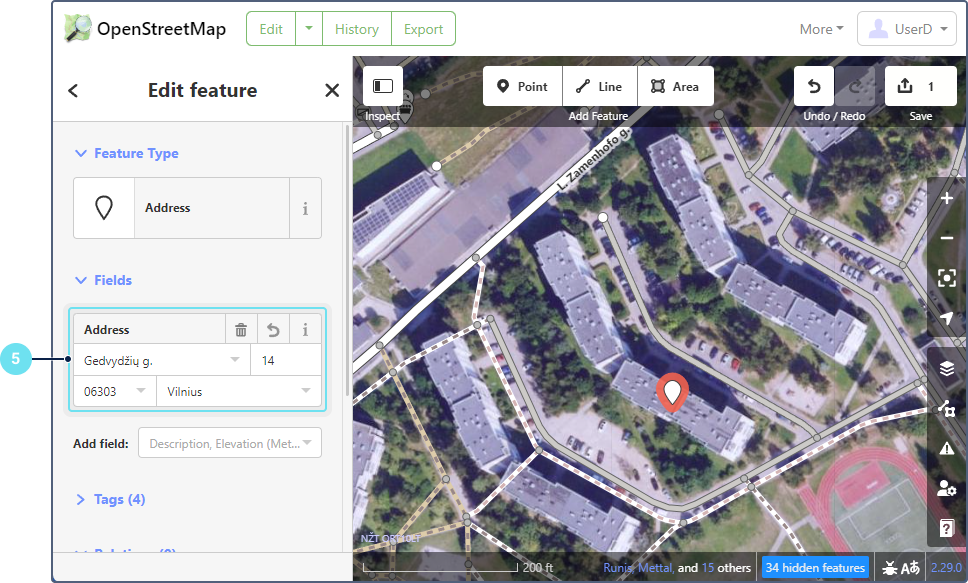

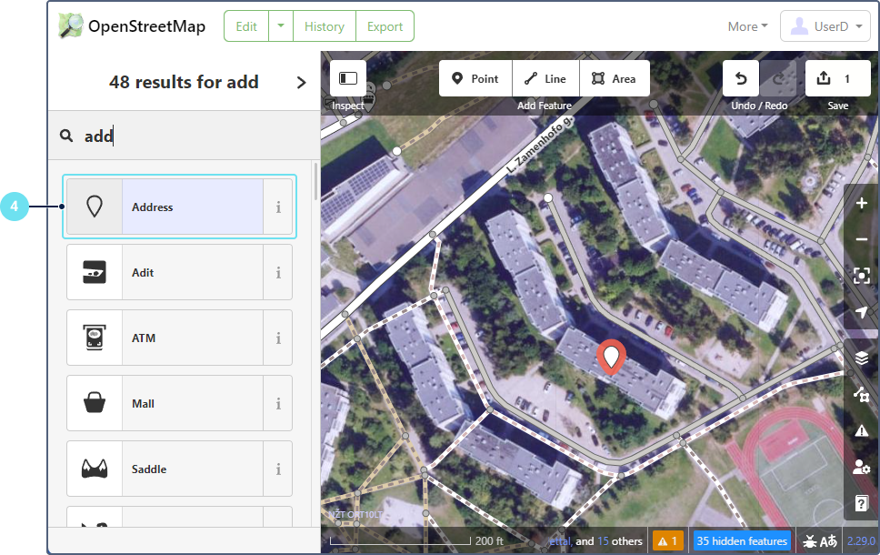

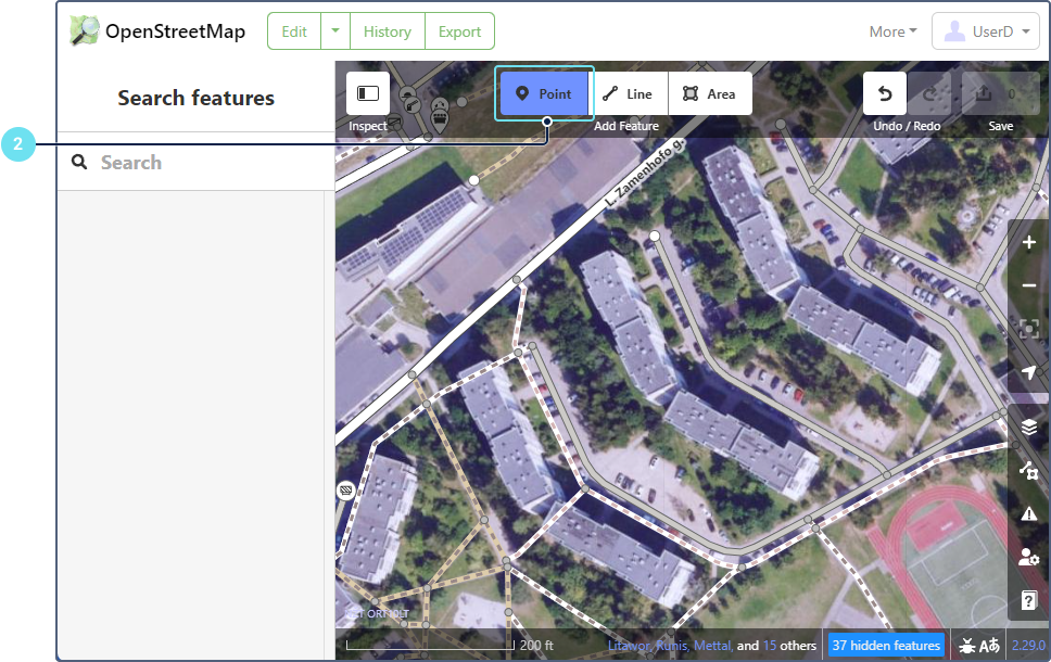

Adding an address point
To add an address point, follow the steps below.
  1. Zoom in on the required location.

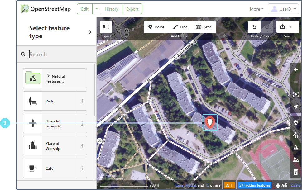

  2. Select the Point tool.
  3. Click where you want to place the address.
  4. Select Address in the sidebar. To find this item, you may need to type Address in the search field.
  5. In the sidebar, fill in the address details:
    • house number;
    • street name;
    • city, state, country;
    • postal code.
  6. Click Save (or press Ctrl+S on the keyboard).
  7. Review the changes and upload them. See Reviewing and completing.
Updating an address point
To update an address point, follow the steps below.
  1. Zoom in on the required address point.
  2. Click on the point to select it.
  3. Move the point if necessary.
  4. In the sidebar, update the address details:
    • house number;
    • street name;
    • postal code.
  5. Click Save (or press Ctrl+S on the keyboard).
  6. Review the changes and upload them. See Reviewing and completing.

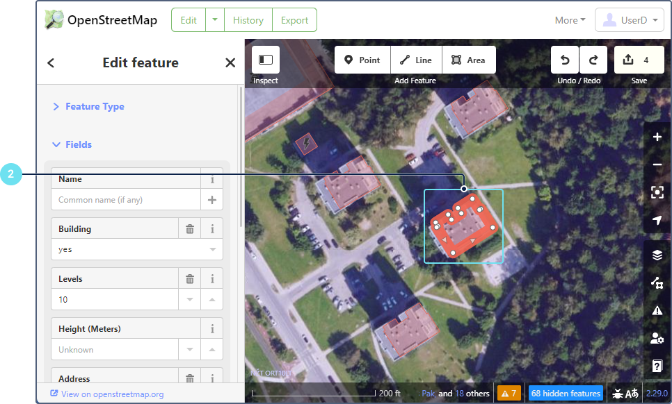

Adding a building polygon
To add a building polygon, follow the steps below.
  1. Zoom in on the required area.
  2. Select the Area tool.
  3. Outline the building. Press Q on the keyboard to square the corners.
  4. Select Building in the sidebar.
  5. Fill in the address details.
Updating a building polygon
To update a building polygon, follow the steps below.
  1. Zoom in on the required building polygon.
  2. Click on the building to select it.
  3. Correct the shape if necessary.
  4. In the sidebar, update the address and building details.

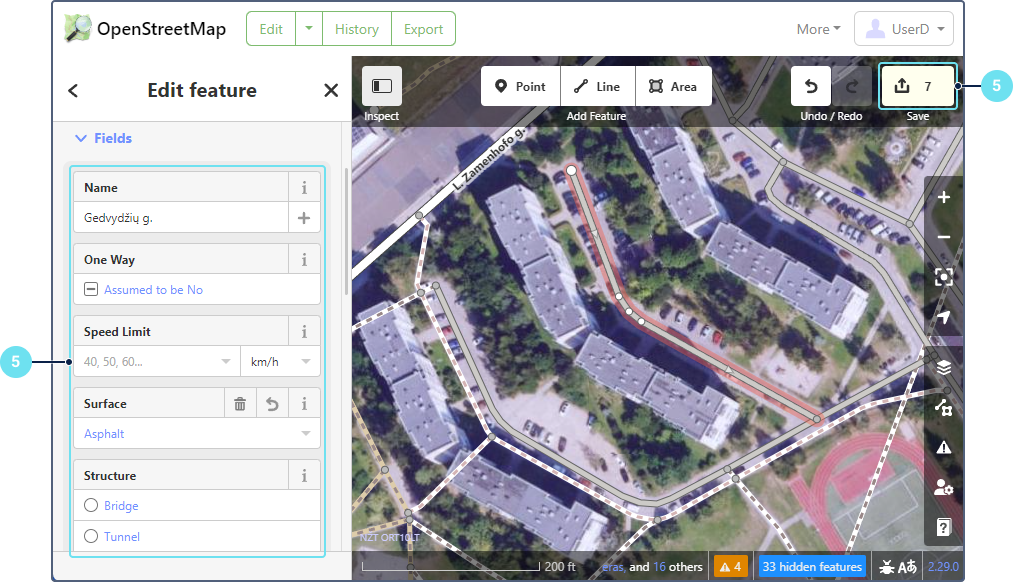

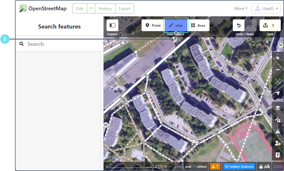

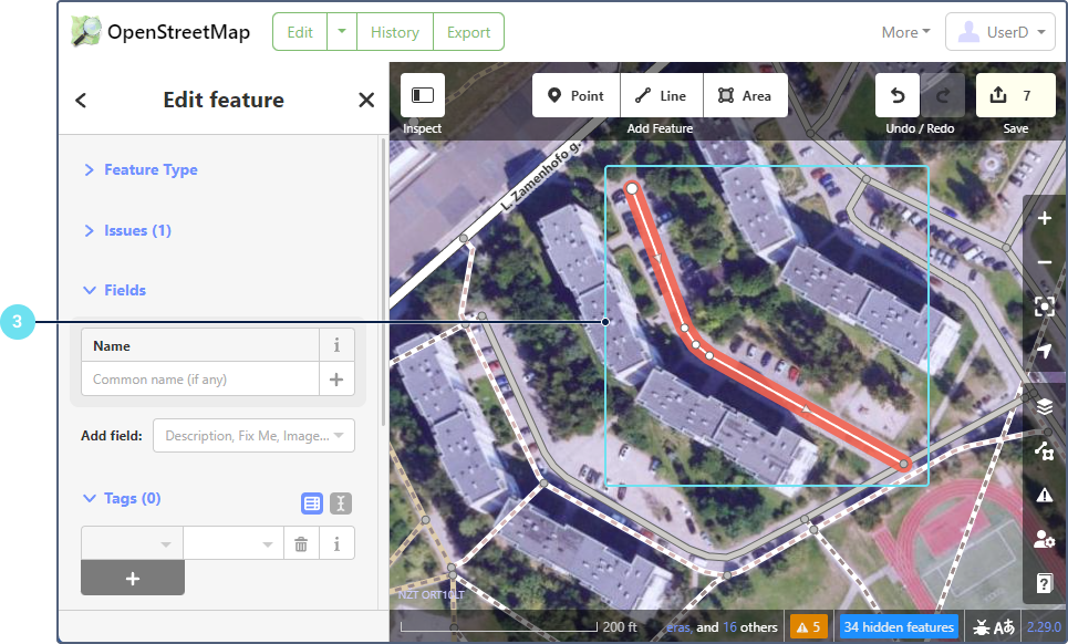

Adding a street
To add a street, follow the steps below.
  1. Zoom in on the street location.
  2. Select the Line tool.
  3. Draw the street path.
  4. Select the appropriate highway tag. Read more about highway types here. In our example, it is a service road.
  5. Add the road name and other tags if needed.

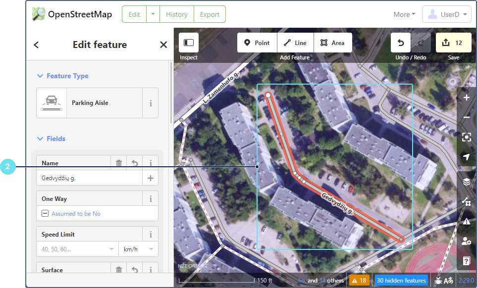

Updating a street
To update a street, follow the steps below.
  1. Zoom in on the required street.
  2. Click on the street line to select it.
  4. In the sidebar, update the street details.

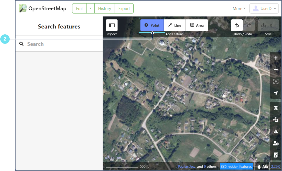

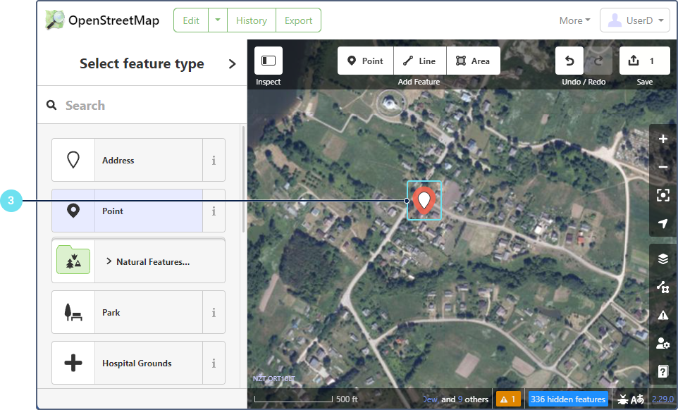

Adding a place of the point type
To add a place of the point type, follow the steps below.
  3. Click where the place should be located.
  4. In the sidebar, select the place type (for example, hamlet, town, city, village).
  5. Specify the relevant details, such as the name and additional tags.
