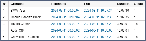

There are some peculiarities in configuring tables for unit groups. The first column of the table shows the list of all units included into a selected group (in alphabetical order). This column is put in front of all the other ones indicated in a template. The Count column (if included in the report template) shows the number of events registered for the reporting period of a given unit.
Below is an example of a table on parkings for a group of 5 units. The table provides us with the following data: the beginning of the first parking, the end of the last parking, the summarized duration of all parkings for the reported period. Every line is dedicated to a single unit.

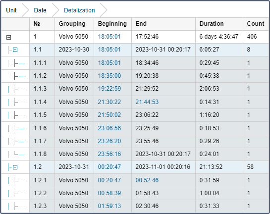

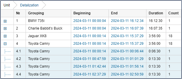

If the option of detalization is applied, the nesting level appears. This means that you can expand the contents of a basic line (‘+’ at the beginning of a line, or the corresponding number in the heading of the column) and see the detailed list of events for a given unit. The number of hidden lines corresponds to the number in the Count column.
In addition to detalization, you can apply the grouping by years/months/weeks/days/shifts. In this case, the table data is grouped by a selected time interval. If several grouping intervals are chosen, they are arranged in several levels of nesting. If grouping is set, detalization can be found on the final level of nesting, and it still shows a detailed list of events for a given unit.
To expand the enclosed information, click on the plus-shaped button at the beginning of each line. It is also possible to expand the nested levels by clicking the corresponding numbers-buttons in the heading of the nesting column. To hide all the expanded lines, click on the button ‘1’.

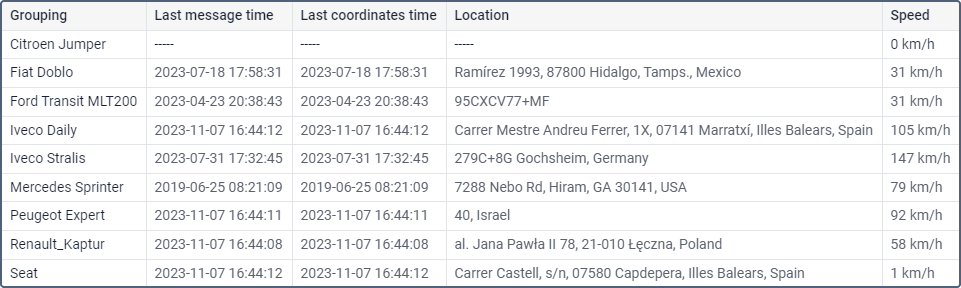

Unit latest data
The Unit latest data table is available only for unit groups. Information on individual units is available in the statistics. The table shows the latest data on the location of units and the values of their counters.
Below are the columns which can be selected to form the Unit latest data table.
ColumnDescription
GroupingThe column with the names of the units (appears automatically).
Last message timeThe time when the latest message from the unit was received.
Last coordinates timeThe time when the last message with valid coordinates was received (not always coincides with the previous column).
LocationThe address or coordinates of the last location.
SpeedThe speed according to the last message.
MileageThe mileage counter value.
Engine hoursThe value of the engine hours counter.
TrafficThe value of the GPRS traffic counter.
DriverThe name of the driver (if detected).
TrailerThe name of the trailer (if detected).
NotesAn empty column for your custom comments.
By default, the latest information refers to the time of the report execution. However, the latest information at the end of the report interval can also be displayed. To do this, enable the Consider report interval option in the table settings.
