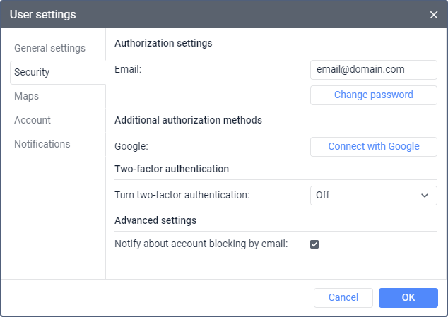

Security
On the Security tab, you can configure authorization and enable two-factor authentication.
Authorization settings
In this section, you can specify your email and change your password.
Email
An email address is required to recover the password and to receive a verification code when the two-factor authentication is enabled.
Change password
In order for the user to be able to change their password, the Can change password option should be enabled in the user properties.
To change your password, enter the current one and then the new one (twice). The new password should differ from the current one and meet the security requirements (see more). Click OK to save the changes.
When changing the password, you can’t make more than 10 incorrect attempts within 5 minutes.
For security reasons, all user tokens are deleted from the system after the password is changed.

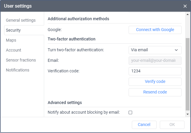

Via email
The code is sent to the email address specified in the authorization settings. To confirm the address, do the following:
  1. Click the Send code button. If you do not receive the code at the address provided, click on the Resend code button. The option is available every 30 seconds.
  2. Enter the received code in the Verification code field. It is valid for 2 hours.
  3. Click on the Verify code button.
After confirming the e-mail address, you must enter the code sent to this address each time you log in to the monitoring system.

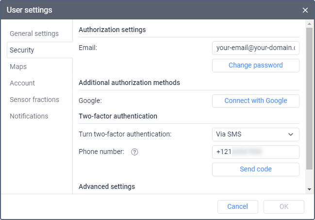

Via SMS
To receive text messages, you should activate the SMS messages service in the account properties and the Can send SMS option in the user properties.
Standard rates apply for SMS messages.
To confirm the phone number, do the following:
  1. Confirm the email address according to the instructions above.
  2. Specify the phone number to which you want to receive the code in international format, for example, +12124567890.
  3. Click the Send code button. If you do not receive the code at the phone number provided, click on the Resend code button. The option is available every 30 seconds.
  4. Enter the received code in the Verification code field. It is valid for 2 hours.
  5. Click on the Verify code button.
After confirming the phone number, you must enter the code sent to this number each time you log in to the monitoring system.

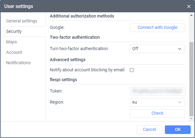

flespi settings
This section is designed for flespi users.
Authorization
To obtain a token, click on the Login button and authorize in flespi.
Token
The field with the generated token is displayed after successful authorization in flespi. The token is valid for one year. To see the information about the status (active/expired) and the expiration date of the token, click on the Check button. If necessary, you can edit the token manually.
Region
The data of flespi users is stored in a data centre in the Netherlands (the eu region).
