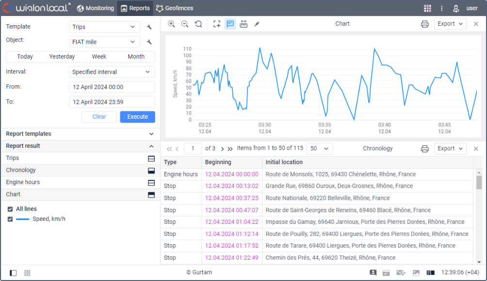

The Report result section shows the list of the report contents: statistics, tables, and charts. To open the necessary component, select it in the list. The first component from the list is open by default. The name of the selected statistics, chart or table has a darker background.

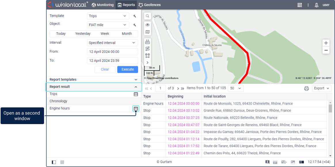

You can open two report components at the same time. To do this, click on the icon   in the row of a table, chart or statistics and select one of the options:
  • Show at the top, to display the selected component instead of the map.
  • Show at the bottom, to display the selected component in the lower part of the screen. The component displayed there previously is moved to the part occupied by the map.
Depending on the selected option, the icon changes to    or , respectively. Click on it again to interchange the positions of the open windows. To close a table, chart or statistics, click on the icon   in the upper-right corner of the window.
