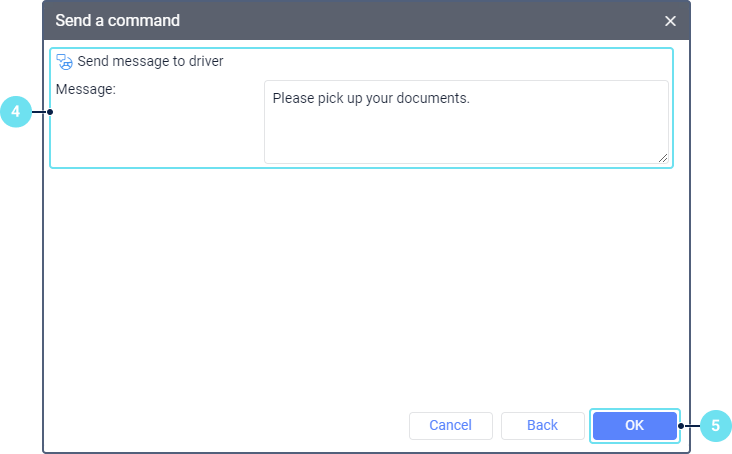

To send a command, follow the steps below.
  1. Click on the icon  in the row or additional menu () of a unit or group.
  2. Select the required command from the list. It shows only those commands which you can send now, depending on the available transmission methods. If you are going to send a command to a unit group, the following icons can be displayed next to the commands:
  •  : you can send the command to all the units of the group;
  •  : you can send the command only to some of the units (point to the icon to see the details).
  1. Click Next.
  2. If necessary, specify the additional parameters, for example, coordinates, the number of a digital input/output, the frequency of data sending, etc.
  3. Click OK.
The records of sending and executing the command are shown in the log.
